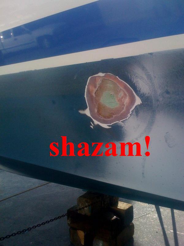

    Once again, disregard what I do for a living, assume I have no credibility whatsoever. Let's begin with this fairly innocuous void that was found in the laminate of this near new 450 Bertram...

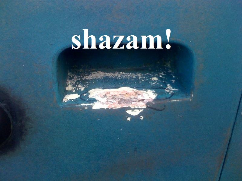

    What's the big deal you say? What we're looking at is the molded in step at the stern of the vessel on the stbd side just below the transom door. After all, anyone whose done any lamination can tell you that a part like this may be difficult to laminate and that there may be a bubble or two in the laminate if its not rolled out properly. What this little void did though was trigger the owner of the vessel to hire a surveyor who sounded out the hull which revealed over 90 other voids in the hull below the water line. That's bad news.
    But here is a perfect example of the people laminating the parts for Bertram not knowing what the hell they're doing...

    For the astute among you, do you recognize the core material? We've seen it before on this forum. Does anyone remember me saying something about the core used here "outgassing"? That's precisely what's happened here, after lamination the core continued to cure and "outgass" causing the voids throughout the hull to develop. Worse still the core should NEVER HAVE BEEN INSTALLED BELOW THE WATERLINE! IMO the proper core installation in a pleasure boat hull should start 6" above the waterline, the overlap of the laminate in the chine area from the hull sides and the bottom more than compensates for the lack of core from the chine to where the core SHOULD start above the waterline.
    Again, forget my credibility or what I may or may not do for a living, look at the photos and use common sense to decipher what's in the photos. Digest what I've posted and if you guys are still interested, tomorrow we'll look at a NEW 570 sitting on the production line.

    Do you have any photos showing the boats that these problems are on? I mean showing the boat with the voids and coring below the water line? I would like to see those if possible. IIRC when Bertram started using coring they, like a lot of other builders, cored beneath the waterline, I am wondering what vintage this boat is and if that is a possible explanation.
    I am not doubting you, just want some clarification.
  8. NYCAP123
    11,209
    I'm no coring expert, but truthfully I was expecting to see 20 boats with their bottoms pealing off. This stuff I've seen on hundreds of boats, and not just Bertram. Looking forward to the rest of the shots.
