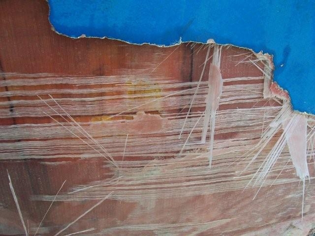

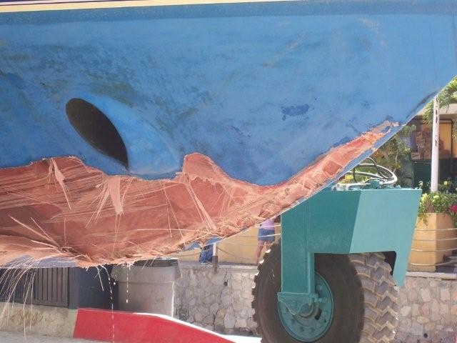

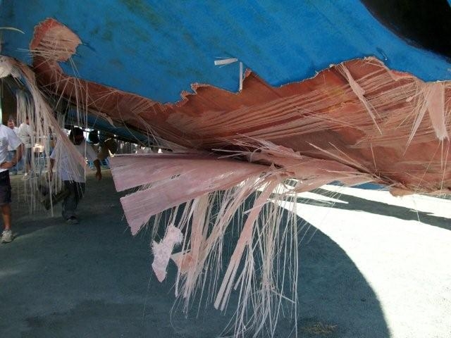

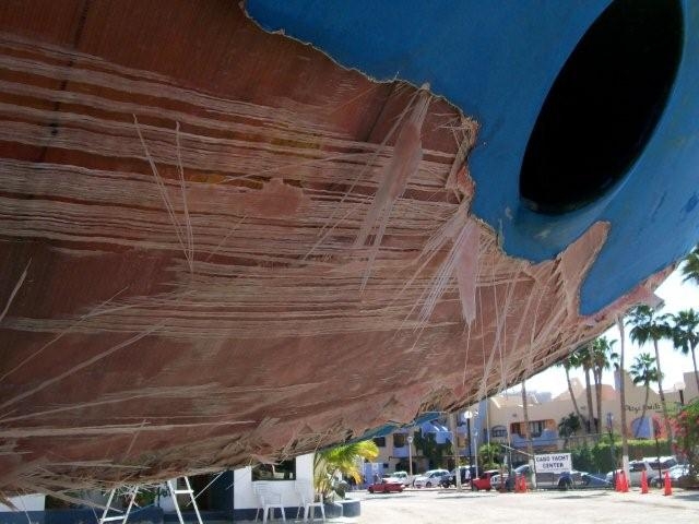

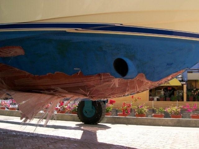

    trisdee80, u can see the delaminating in the pics, up front where the core is peeling away from the outer layer (looks very similar to 'Certifiable')... bulkheads doing the same thing... just peeling away, no fractures... ill do a simple test sheet if u want?

    Look at the one picture where the bulkhead is pulled away from the hull. This is the most telling in my opinion, and I have not heard anyone mention this. The fiberglass tabbing is pulled cleanly away from the hull, with no breakage of the hull or the tabbing in this area. There is no marring of the hull side - as if the tabbing was never there, except for a slight discoloration absent in the area previously covered by the tabbing. I'm no composites expert, just a lowly mechanical engineer with a boating fetish - but it seems to me to be plain as day that in that particular area, there was no adhesion between the tabbing and the hull.
    Well built in the context of how a 63' Sportfisher should be built? No. Of course not, it doesn't need to be and such construction would be contrary to the intent of the boat.
    Well built for a production go-fast? Yes, definitely. Just a quick look at the picture you're referencing should be an indication of how well built the boat is - it was cruising at least at the top speed of this bertram when it hit that pole, and it still didn't suffer delamination. I'm going to go out on a pretty **** sturdy limb by saying that just about any Fountain you find, even with a rotten stringer or two, is a better hull than this particular sportfish. But that's like saying a wooden board is built better than a toothpick - you don't have to be an expert to see major problems in the construction of this particular Bertram. It should have been able to hit a wall of these bouys and keep on cruising.
    Regarding cored hulls - Fountains are cored all the way through. They're a good boat for what they are - and this is a good application for a cored hull. Note that most Fountain owners (myself included) store their boats out of the water, either on a trailer, on a hoist, or on a rack. I do this at least in part to minimize the risk of water intrustion into the core - if there's no water in the bilge and no bilge in the water, the core and stringers stay dry. On a cruiser, sportfish, anything that i'm going to put bottom paint on and leave in the water, i'm staying away from cores below the water line, no matter how well built.

    These are some amazing pictures! As if this thread isn't long enough already, I'm sure it will double as these pics are analyzed. Or is there really a lot of analysis to do?
    Certainly this incident will have to be considered in its own right and in context of other incidents mentioned, especially on related models.
    As the damage was so high on the hull, I'd be really interested to hear more from the crewmembers about sea conditions - were they really running into waves, and what were conditions the previous couple of days on the trip.
    Since the damage does not appear to be from a bouy strike, could the deck have been separating from the hull, maybe for some time?
