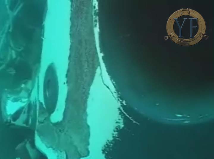

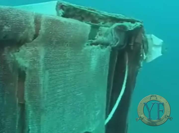

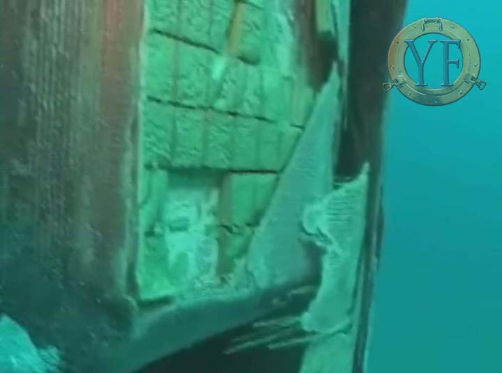

  20. YachtForums
    20,948
    Hi Bruno,
    Most of the video was filmed up-close for better clarity. Here's a series of shots taken at the starboard transom corner...
    1. In the first shot, you can see the exhaust outlet, as viewed from the starboard side of the boat. The underwater light, seen to the left of this image stayed intact, as did the opposing side. This would be expected because all thru-hull fittings are solid glass.
    2. The second shot is halfway up the transom, viewed from the port side of the boat.
    3. The third shot is at the top of the transom, also taken from the port side, showing the rubrail protruding out from the corner.
    I posted these shots because they are just above the rudder that was torn from its mount. The more I study the video, the more convinced I am that the rudder and the transom (where it meets the bottom of the hull) was the first point of impact when the carcass impacted the sea bottom.
