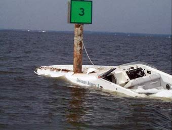

    The top of that buoy is PVC pipe, and the radar reflector is aluminum. Can anyone, I mean anyone, please explain to me if this buoy caused this boat to sink, how there is no damage to the mast or reflector. Even an unlikely explanation? I just don't see any way at all. All I keep reading are ways that the buoy could have caused the boat to sink. These seem a little far-fetched, but possible. But how did it do it without considerable damage?

  13. Marmot
    Marmot Senior Member
    May 20, 2007
    3,300
    9114 S. Central Ave
    You have neglected time. I can slowly push a 1000 ton vessel off the dock by leaning on it. I would shatter my fist if I struck it.
    At 25 knots (42 fps) just how long do you think it took to inflict the damage to the bow illustrated in those photos, and how far do you think that buoy would have moved in the same time?
    Your comparison with a wind borne 2X4 is specious. The boat was not found with a buoy shaped hole in the bow, and the 2X4 did not destroy the wall.
    The boat being discussed suffered a large force over a large area over an extended (in this context) period of time. The deceleration was rapid but not enough to injure the occupants.
    Just for grins and to illustrate how much energy can be absorbed by a composite structure loaded over a small area, ponder this:

    Great comparison, the boat pictured is/was a fountain, hardly a well built boat. . That should be the end of the discussion right there. To further claim that the buoy did the damage is really truly idiotic.

  18. 84far
    84far Senior Member
    Dec 15, 2008
    794
    Brisbane, AUS
    that doesn’t work.... that beacon is solid, not moving for anyone, agree? If that buoy was the same, static, not moving, in the ground 10 feet, it would have the same effect as that beacon, it will ‘slice’ up the boat as well, but also show damage to the reflector …. But it doesn’t…
    test a) get a alloy pole 38mm and stand it up under its own weight…. Now punch it… it will fall over from the force applied to it, agree? Test b) Now get the same pole and cement it in a few feet, and punch it…. You’ll be off to the doctors. That buoy is ‘test a’, but correct me if I’m wrong, better be a good equation if i am wrong?
    That 630 at that weight and speed should (if it did) bowled that buoy over with damage to its lower parts of the hull…
    Also this is not a bash on Bertram, it’s a bash on the technology used. Unfortunately Bertram just happens to have there name on it.
    far
