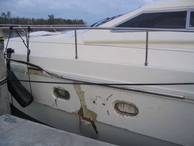

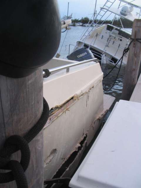

    when you look at hurricane damage, solid glass boats show a lot of grinding and scraping before the hull fails, it takes a long time to happen.
    on the otherhand, look at cored hulls... often there are no or very signs of repeated grinding agasint the dock or pilings. Here are a few pics i took of an older cored Ferreti, at Dinner Key, after Wilma. It stayed afloat since the damage was above WL, but you can see the hull failed with very little scraping.
    as to the mast impaling the bow, i still dont' buy it. the mast woudl be completly mangled or gone and the odds of the angle being such that it would actually penetrate are zilch
