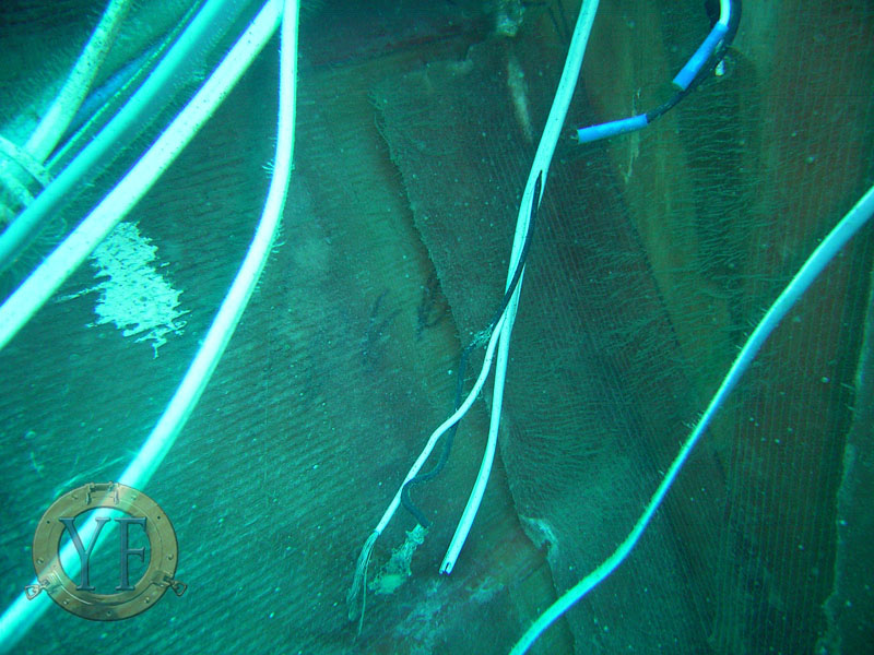

    Pic #26, i think it backs up my theory a little. if the buoy ripped the boat apart there would of been a fracture in the glass (support bulkhead). None of that can been seen. To me it looks like its been pulled apart slowly, and I feel that this was already damaged before all this happen.

    it also looks like the core is not adhering to the outer layer…? I think the boat CERTIFIABLE may come back into question.

    The pics are great. I use to be in the marine salvage business and have recovered a vessel that sank from a mechanical failure. It had the transom pretty destroyed also. But I always thought it was caused by the vessel bouncing around on the bottom nose up. But with this Bert's bow missing that's not likely, I guess. Is it possible the boat has been bouncing or rolling around from sea action? I'm on the West Coast and wrecks commonly move around on the sea floor.

    6. The boat had a catastrophic failure with massive damage to her hull, both forward and aft.
