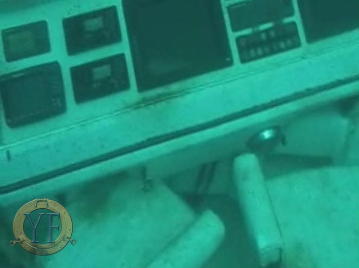

    Okay guys i just looked at this one for 5 min.... Whats the ansewer for this one....... :eek:
    Carl, what did the hard top look like? was it intact? I would love to see a forward pic of it if you can...Thanks
  8. jbk4001
    jbk4001 New Member
    Nov 14, 2009
    85
    BrielleNJ
    it looks like someone cut the whole helm pod out of the boat with a sawzall!!
  9. YachtForums
    20,948
    I've got that pic! Will post in a few minutes. I remember looking at it and thinking "where the hell is the wheel?" Good eye gents. Back in a minute with the picture...
    Update: I don't have the pic (yet). It's on the video, which is 20 minutes long. It will take a few minutes to get the screen shot. Back shortly...

    i think the skipper has ripped off the helm/pod. the boats stopped, but the skipper is still moving forward... ouch
    far
  13. jbk4001
    jbk4001 New Member
    Nov 14, 2009
    85
    BrielleNJ
    Only one thing (besides a sawzall) can blow that pod out like that…….and that’s water!! AND LOTS OF IT!!!:eek:

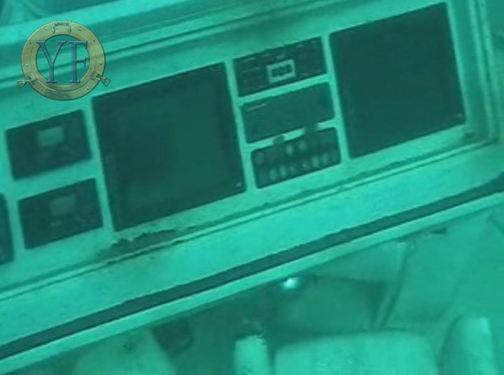

  14. YachtForums
    20,948
    OK, here's two screen shots of the helm, about 10 seconds apart. Where's the wheel???

  17. jbk4001
    jbk4001 New Member
    Nov 14, 2009
    85
    BrielleNJ
    the entire console had been torn off. look how close the helm seat is to the consol Vs the built in foot rest the chair and helm pod are where they belong the console had dislodged and moved aft. Lots of water to do this!!!

  20. SHAZAM
    SHAZAM Senior Member
    Jan 26, 2008
    601
    The Ghetto
    Console has not moved, the hinged portion of the console with the electronics has come "unhinged" and partially obscured the pod that contains the wheel and the control levers.
