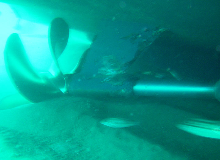

    The forward deck looks to me as if it was ripped away and took some of the above the waterline hull with it. What caused that? Stuffing the bow into a wave? Stuffing the bow into a buoy and a wave? IDK (I don't know) and at this point we don't know (WDK). The strut looks as if some chain got between the shaft and the hull. What else could have caused the strut damage? Lots of things but WDK. What caused the transom to come off? Is that related to the forward deck coming off? I'd venture to say yes- but WDK. How about the bent back rudder? Was it caused by striking something? Does not look like it- but WDK. Perhaps the area was weakened by the same forces that caused transom to come off.

    I am not convinced that the strut has damage. If it's older ablative paint, especially when applied spec boat thin, it could easily just be hydraulic paint wear and some growth causing the illusion in a fuzzy picture there is damage. I' don't see any physical indicators of damage such as twisting or tearing of either the strut or hull interface or what is visible of the prop. The prop looks pristine from what I can see of it.

    Henning, you've made two posts in this thread that exactly mirror my own extrapolations. The quote above is one of them. I have attached a close-up image of the strut/shaft/prop in question. Upon closer evaluation, I think you are correct. Nothing has wrapped around the strut (how could it? The shaft is in the way!). It's simply an example of ablasive bottom paint wearing off, giving the illusion of damage.

    I tend to agree. That prop, at least what we can see of it looks fine. As does the hull above the strut and shaft.
    And I still can't see any damage to the rudder that would indicate it hit anything.

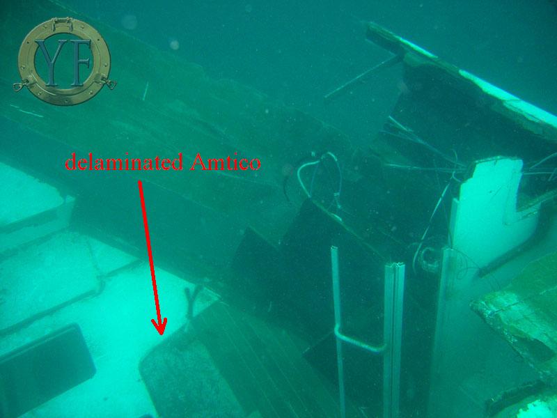

    Take a look at the photos that show the stbd side head (or what's left of it). Notice the amtico flooring, half of the amtico is missing.
    Do you guys think that Amtico will honor their warranty on the delaminated flooring?
