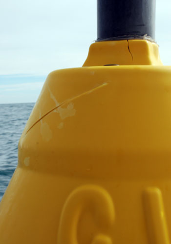

    WOW!!! I'll never underestimate one of them **** little yellow buoys again! :rolleyes: ;)

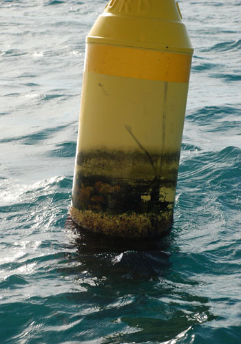

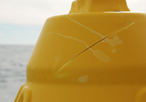

    if the boat had impacted the buoy, there would some damage at the bow below water line... visualize the position of the bow at speed, there is no way for the buoy to hit and cause impact damage so far up.
    is it possible that the catastrophic damage seen in the bow and foredeck area was caused by trapped air which had nowhere to escape once the boat got deeper in the water, and eventually exploded the bow?
    i don't understand the rush to blame the captain here. well, i can understand it from Bertram but not from other captains. The damage to the rudder indicate that the boat hit something but until proven otherwise, I'm betting a something lurking just under the surface. there is no way that buoy would have ripped that rudder.
    unless the rudder damage occured when the wreck hit the bottom, remember it may not have landed vertically but with some forward speed.

  4. NYCAP123
    11,209
    The buoy's mast stands about 12' above the water and rocks. If the boat came down as the buoy leaned toward it that would put the mast at just about the right place to lift the deck off and leave the buoy virtually unscathed.

    I think it's *clearly* obvious that the buoy in question is not responsible for the catastrophic failure the boat had. I'm no expert, nor do I claim to be, but I'm pretty confident in that statement. Betrams letter, CYA / Corporate Kool-Aid.
    No. Not enough air pressure, force or buoyancy to do so. Air, like water, like electricity is lazy, It finds the path of least resistance to escape.
    Agreed- The buoy didn't cause it the damage to the bow, nor the running gear. The boat sinking couldn't have had enough speed or inertia to do the damage to the rudder or running gear as seen there. You figure for something that size, with that much displacement in / of the water, the amount of speed it's going to have when hitting the bottom is going to be very little. Perhaps a MPH or two. not to mention, it looks to be a pretty soft / sandy bottom.
    I don't put any blame on the captain.
    If the images from the video don't show you what the issue was, then nothing will. (I'll give you a hint: the impact shown on the buoy in question was not it. At best, it's questionable if the boat even hit the buoy)

    i guess anything is possible, but i think that the mast would have been pushed out of the way, bouncing off.
    on the other hand the buoy could have caused the damage to the strut and rudder but then i believe they'd be more evidence on the buoy.

    But does the rudder show any indication of a strike?
    Hard to tell from the pictures but it did not look bent or damaged. Perhaps as the transom and/or hull de-laminated the rudder just pulled it's mount out from the force of the water flowing passed it?

    I'd have to say perhaps #2.
    But it's hard to believe just hitting a buoy like that could have done that much damage even with lousy construction.
    And then other than the marks on the strut I don't see any other indications that it hit something in the water that could do that kind of damage. It seems like you would see some indications of a hit lower on the bow and hull.

    It appears to me like the mast of the buoy opened her up like a can opener - then once she was breached and stuffed in a wave, it's all over. Once structure is gone, boat hits bottom transom sheers off - very understandable. It is pretty apparent buoy was impacted, and for a propellor to mark it, it must have been centered, consistent with center bow being punctured. Also, only explanation for severe running gear damage is to run over something hard (like chain and or underwater section of center pole) at speed - NO WAY that strut (and rudder) get's that kind of damage by hitting soft bottom. The running gear proves to me beyond a reasonable doubt this boat ran something over - what happened next can be debated.
