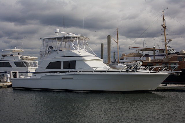

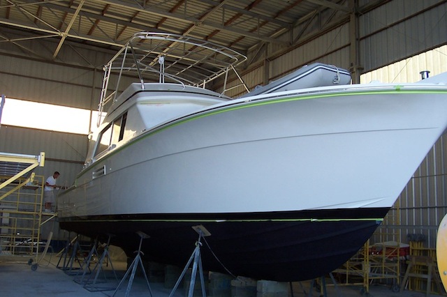

    My 1984 Bertram 54 will be going back in the water in just two days. It has the 12V71TI engines.
    Changes include one fresh overhaul with low hours on the other, removal of the full tower and replacement with standard soft top, fresh bottom paint.
    I am hoping for an easy 22-23 knots cruise and 28 knots WOT. I will be really happy if I see 24 knots cruise and 30 knots WOT. I know the fuel burn even at 22 knots will be positively insane so I'll probably spend the majority of the time cruising at 15 knots.

    How did your see trial go finally? Boat looks amazing!..
    How much did you pay for a rebuild? What are you new cruising and GPH numbers?

    I don't think he got to the 24 cruise/30 WOT. I have the same setup and have a 20/21 cruise burning 60 gal and 29 WOT burning a hole in my wallet

    I'll check again soon ... I believe I have 26 knots WOT which is precisely what the boat did before the rebuild but with a full tower at that time.
    I'm really enjoying the boat and very happy to be free from Orange Beach, Alabama. My service experience there was piss poor.

    I'm seeing around 20 knots at 1850 rpm with full fuel. 1450 gives me approx 14 knots. I have not considered moving the air intakes as I have no reason to believe the engines are being starved for air and have not been looking for a place to put many many thousand dollars. My engines are the 12V71TI 800 hp versions. This speed is several knots slower than I would like but the boat feels great at sea, is burning less fuel than I expected.
    The speed is identical to what it was before the overhaul of the port side engine.
