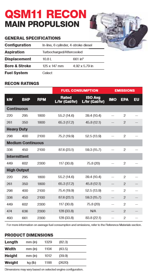

    I am considering purchasing a 43 with the intensions of repowering one day. What is a realistic cruise with the standard 550 HP motors? I need some advice on the best motors to put in and approximate cost to do so. I would like to cruise at least 24 knots.

    I repowered my 95 43 2 years ago and am very happy. Put a couple of Cummings QSM 11s in it. Had 6v92s 550s but they were tired. Maybe 15 knots cruise at 40 gph. Now 24, 26 knots @ 40 gph.

    Just repowered my 95 43 with QSM 11s and very happy. Realistic cruise with the 6v92s is 15 knots @ 40gph. With the Cummings I cruise at 25, 26 knots @ 40 gph. What year is yours?

    I currently have a 37 Bertram. I cruise at 23 knots with 3208 Cats. I would like a larger Bertram but do not want to give up the speed. What horse power are the Cummins QSM 11s?

    68O I believe

    Cummins has a Recon program great for repowers:
