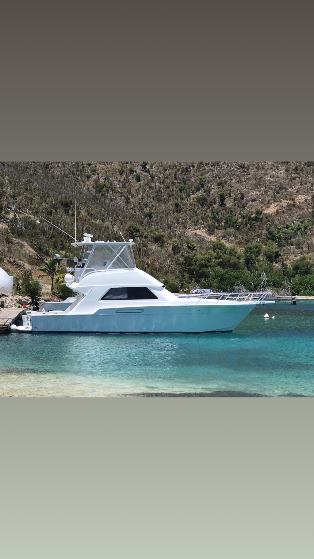

    How did you make out? I just did my 95 43 with 680 hp QSM 11's and are very happy.

    That’s a beautiful blue 43 Jack. Do you still have the 6v92’s?

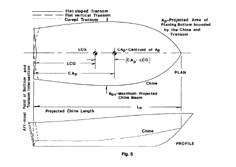

    I would be concerned with moving any Batteries from their Aft location to a forward location. Would at least compensate with robust fish holds that weigh as much as the 4 x 8D batteries that are scheduled to be removed from the Lazarette.
    The balance game is tricky when you do not have a Naval Architect and a lines plan that is entered into a stability software program like Rhino or others. The weight shifts we are talking about are all in relationship to the physical center of gravity and the vessel's center of buoyancy. The Chine Walking takes into consideration the Planing Area and those locations.
    Donald Blount has a good article on the topic, google "Dynamic Stability of Planing Boats" for a NA's perspective of the issue.
    Here is a the classic diagram for starters, it is assuming that the LCG and LCB are in the same location, i.e., the boat is level as it sits in the water with all gear and full fuel/water onboard:
