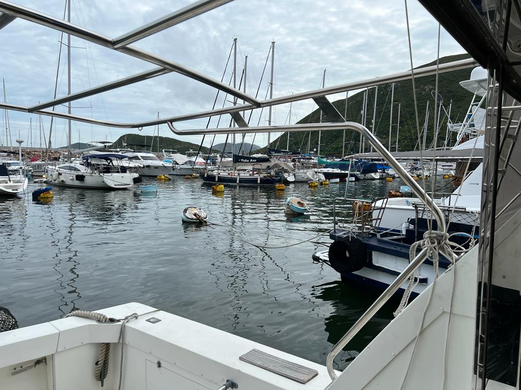

    Heres some project updates!

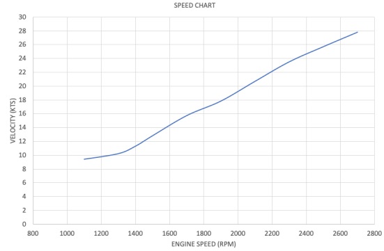

    So the boat hit about 28knots with maximum throttle at 2700rpm using the old propellers 30x32 3 Blades. I believe changing them can get me better cruising and top speed.
    Redid the exhaust with new Centek 6" to 8" Fiberglass 45 Degree Elbow and Trident Hose / Clamps
    Finished the Interior finally! Tinted the windows with 3M PR40 ! And the rear bimini top!
    Installed new Victron Energy Battery Charger with Cerbo GX. Redid all the 12v wiring with correct marine grade wires and fuses, which the shipyard contractor cheaped out!
