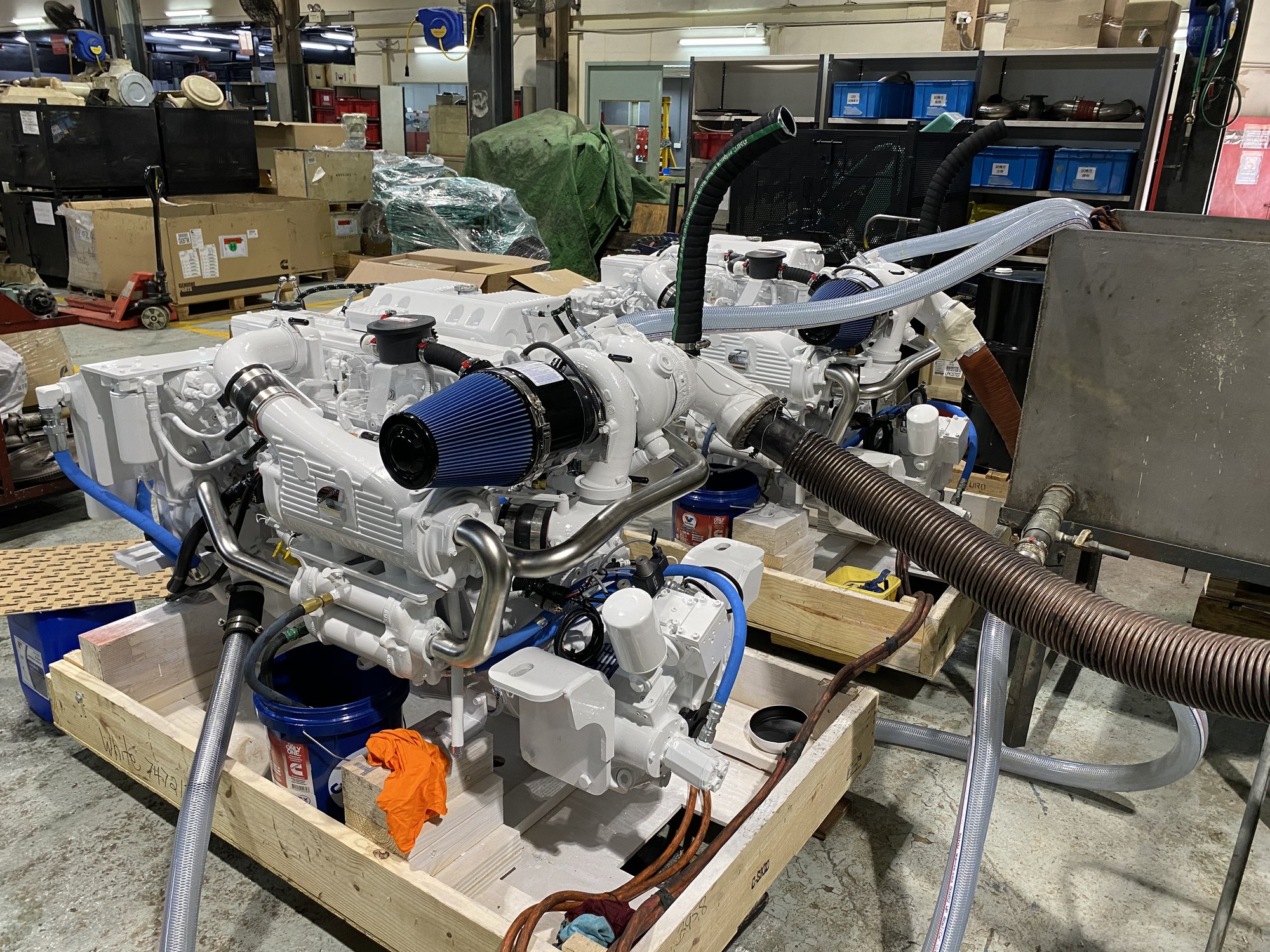

    Finally the new engines have arrived Hong Kong!
    Cummins QSC8.3 493bhp

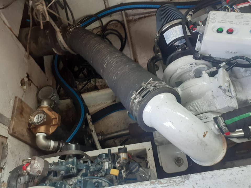

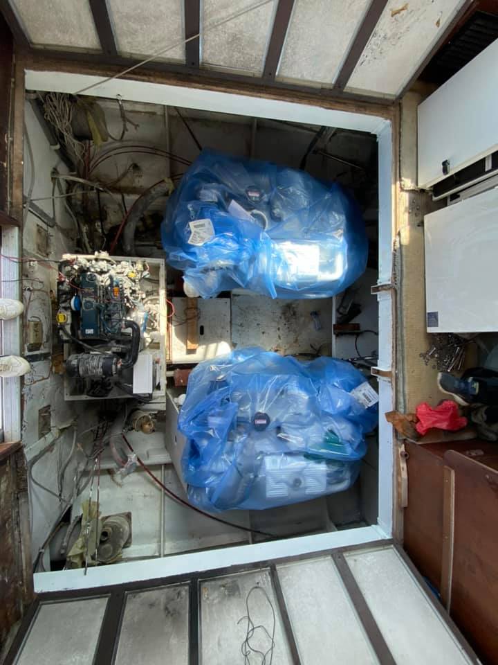

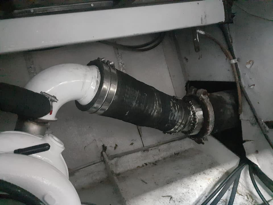

    Engines and Genset are finally in! Fuel lines and Water and exhausts are done! Working on wirings now!
    235698495_10100474669555350_6069081253147833800_n.jpg 236058071_10100475070591670_3054008888807263365_n.jpg 235512583_10100475070292270_3166538848025220984_n.jpg

    What props did you end up going with? Is that a new generator? Will it have a sound shield?
    I'm a little surprised you didn't paint the engine room while the engines were out?

    No, I havent decided on new prop yet, will seatrial with the old one first! Then I would need suggestions on new prop and shaft and trim tabs / interceptors...
    Yes, new generator and with sound shield!
    Yes, I did paint the whole engine bay but all the installation work has made it very dirty...

    I understand the engine room paint issue. I did the same. Painted it with engines out then pretty much ended up painting again after the work was done. Although I'm not sure mine got beat up as much as yours appears top be. I still have a few final areas to finish touching-up this winter.
