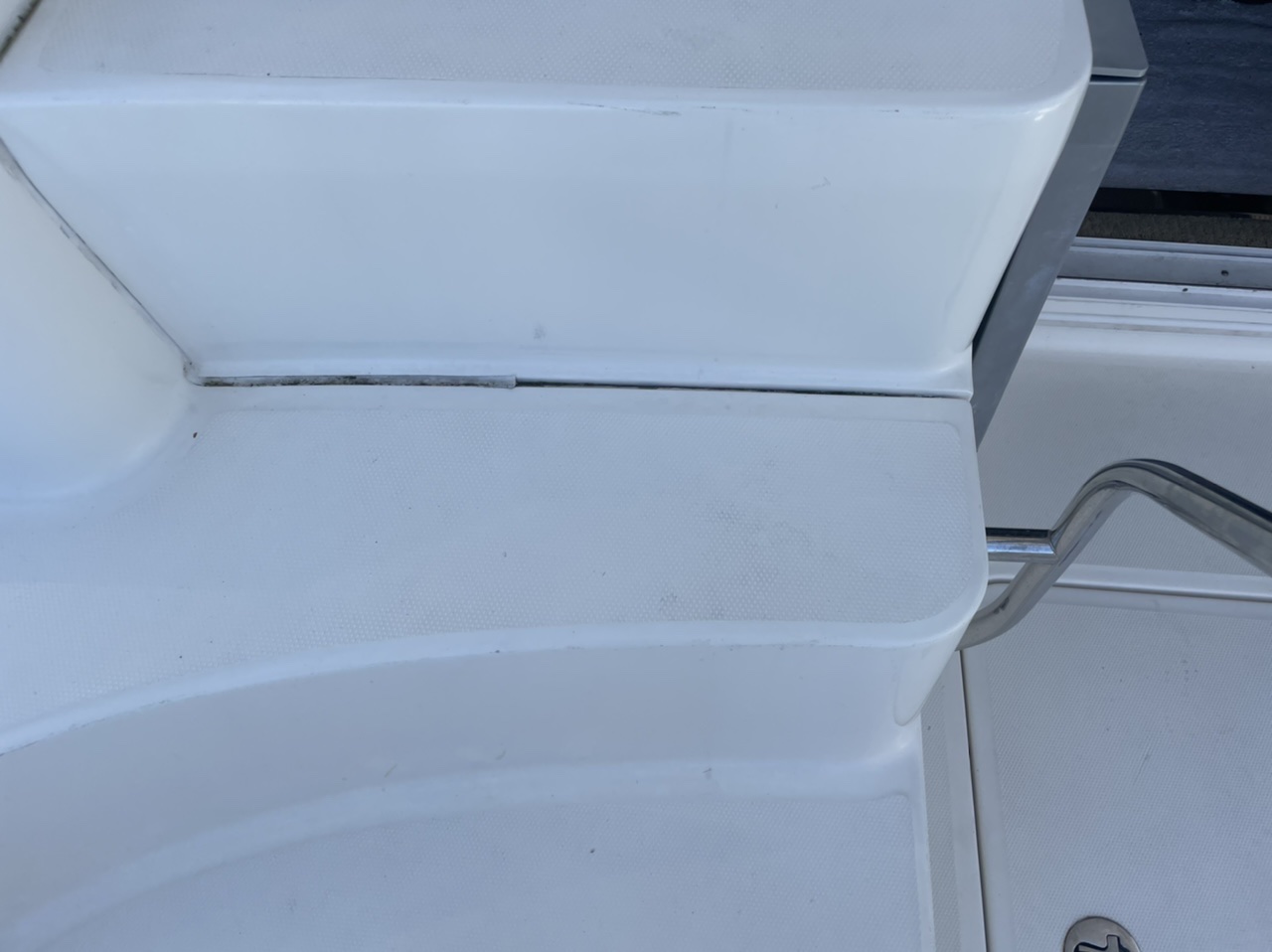

    6A0A72D7-8081-43BC-A75B-C57855DD4E15.jpeg What caulking is best to reseal joints like this on the deck?
  7. Capt J
    14,890
    I life Life Seal (NOT Life Caulk)
