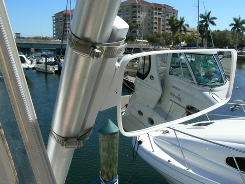

    How about a mirror?
    It's part of my KISS principal.

    Timjet- I would recommend putting something between the s/s hose clamp and your tower leg to insulate the s/s from the anodized aluminum so they don't touch each other.....but good idea that works.....

    Thanks hadn't thought of that. A strip of rubber cut from an old inner tube should work.
