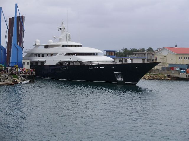

    I've been to Simpson Bay and am familiar with the bridge and bridge schedule. 10 feet to spare is enough clearance to get through without incident. On a yacht that size, wind has very little to do with maneuvering compared to current. Wind usually has little effect, and current has a great amount of effect. It looks like he's going through at about 6 knots. Hitting the bridge on both sides of the yacht is a bit much.
    To me it seems like you could creep through at 2 knots and stand on the bow thruster and split the engines to move the boat sideways if needed to. Just like maneuvering in a tight marina. I have never run anything that big or nearly that big. But the yachts I've run over 100'-146' were very manueverable creeping at 2 knots, and adjusting postion with the bow thruster or engines, even with a lot of current provided it wasn't on the beam which it isn't at that bridge.
    just my 2 cents.

    I saw the boat a couple of days after. The majority of the damage was on the port side. The video looks as if the primary impact was on the port side and then the entire boat bounced to starboard before impacting that side.
    For all the armchair captains- this bridge can be difficult in even the calmest of winds. There is a cross current as well as a slight dogleg just outside the bridge.

    one has to take into consideration that in such close proximity to the walls with such a long boat there could be a pulling effect of the walls. in fact the yacht seems to hit the side wall towards the aft, which may be partly due to this effect. i have experienced this phenomena in the locks in netherlands and it was quite difficult to get out of it.

    I just don't get the port side damage (assuming what's reported here to be correct) although I could understand it happening with that cross wind to port. The captain is running from the stbd wing station, apparantly with the intention to hug that wall, and he seems to stay on it. That should leave close to 10' of clearance on the port side. Wish the video kept going as they turned. Can anybody tell where on the port side it hit? From the video it looks like the captain handled it exactly right and was done in by a deckhand who didn't position that one fender low enough.

    I talked to the bridge engineer and asked why the vessels crash there including the Azteca. The reason was simple as he watches the vessels make the mistakes all the time. I was told that if you come through the bridge with the rudder at any angle other than 0 degrees, you run the risk of getting coch-eyed and unable to re correct yourself, over correcting yourself and you will crab through the bridge possibly hitting.
    He told me Limitless does it right. They line up the boat with the bridge entrance and shoot through like a bow and arrow... No fenders, No rudder, NO BOW THRUSTER. Straight through.

    We have several bascule bridges on LI's south shore, and I've seen many boats screw up. I always advise my people to forget the sides of the bridge and forget the mouth of the opening. Line yourself up on the split in the deck (or in this single deck case it would be the deck itself) to get a straight line in. Looking elsewhere tends to lead you in on an angle, then you're drawn into the sides crabbing as you try to re-center yourself too late. I'm still waiting for someone to say what happened on the port side, because it looks like this captain did everything right from this camera angle. The boat looks to be straight, and is hugging the upwind side which is where the captain is steering from. He has to gauge everything from that side only, once he determines he'll fit.
