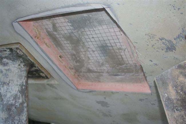

    Received this PDF from an anonymous source. This is not the first time I've heard of this, but it's the first time someone documented the issue with images and presented it for others to see. It appears Azimut's are a little thin skinned...

    The thickness is not a problem in itself, but perhaps the infusion has not been good enough. I would also expect solid GRP in the area of struts and rudders. But how running strakes can detach is a mystery?
  3. YachtForums
    20,691
    The area of the hull above and aft of the prop is exposed to a lot of turbulence. If the skin is thin, it is more likely to flex. This would would cause the foam behind it to deteriorate, further compounding the issue. The comment in the PDF about a strake detaching is unusual. Maybe the owner is referring to the strut?

    Looks like they got it backwards and put the foam in before the coring. Either way this can't be good.
  5. Pascal
    8,716
    what do you mean? the foam is the coring! not sure what they use, i dont' think Divnicel comes in pink, does it?
    i'm not a fan of cored bottom, but the area aroudn the struts and rudders should be solid glass... this is really unbelievable.

    The foam is the core.

    I was looking at that checkerboard surface and thought that might have been the coring. Oops!
    I understand foam coring above the waterline, but not below and in high stress areas.

    The checkered pattern is from the grooves in the foam core, where the resin is spread through the infusion.

    That checkered pattern is essentially a weave of foam cubes held together by a membrane, allowing the foam to contour to compound curves, while providing areas for the resin to wick.
