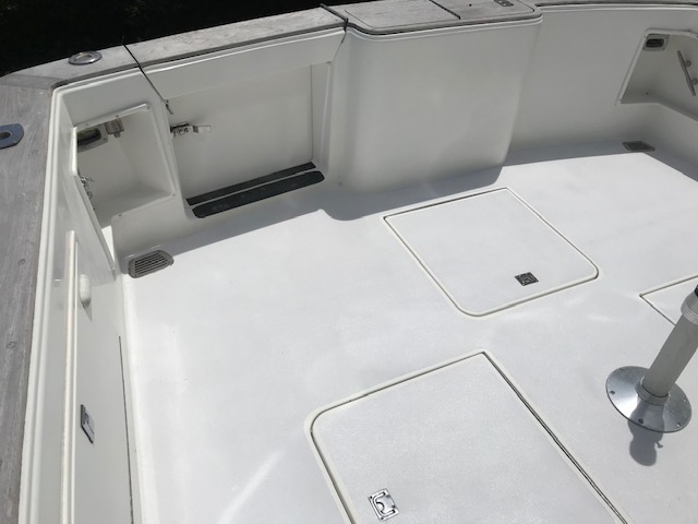

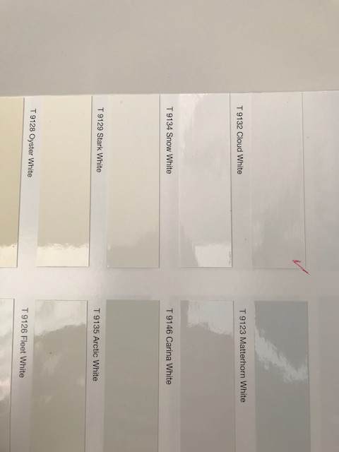

    I am going to paint my cockpit this spring as well. I am going to go with Alex seal instead of Awlgrip. I took a pic at a location under my gunwale . See attached. Top portion of the photo is the gel coat area under the gunwale. Tough to say, I think I will go with the T9132 Cloud white for mine. You can request the color selection guides from both Alex seal and Awlgrip for free to try and figure out which is best for your application.
    I never used this paint before, everything I read says prep is key. Have to sand entire cockpit and clean with cleaner de-greaser. Going to prime and let dry for about 12 hours. Next apply first coat of paint. While still wet, will liberally apply soft-sand and let dry for approx 12 hours, clean off excess soft-sand, then a second coat of paint. Second coat a little heaver then first so that it absorbs into soft-sand. Then follow up with a third coat in less than 24 hours of second coat. Important note is to follow up in less than 24 hours between coats so you don't have to sand and can go over the top of previous coat. Check out Andy Miller / Boat Works Today on YouTube if you like. He has some good videos on this. Wish me luck and good luck with your color match & paint !!

    Rick, I'd highly recommend Awlgrip or Awlcraft over Alexseal for a cockpit. Alexseal is pretty soft and scratches easier IMO. Also, you want to lay on coats within an hour or so if you're spraying it. Rolling a tipping a bit less often as you're suggesting. I'd only put sand in the first coat and then 2 coats of paint over it.

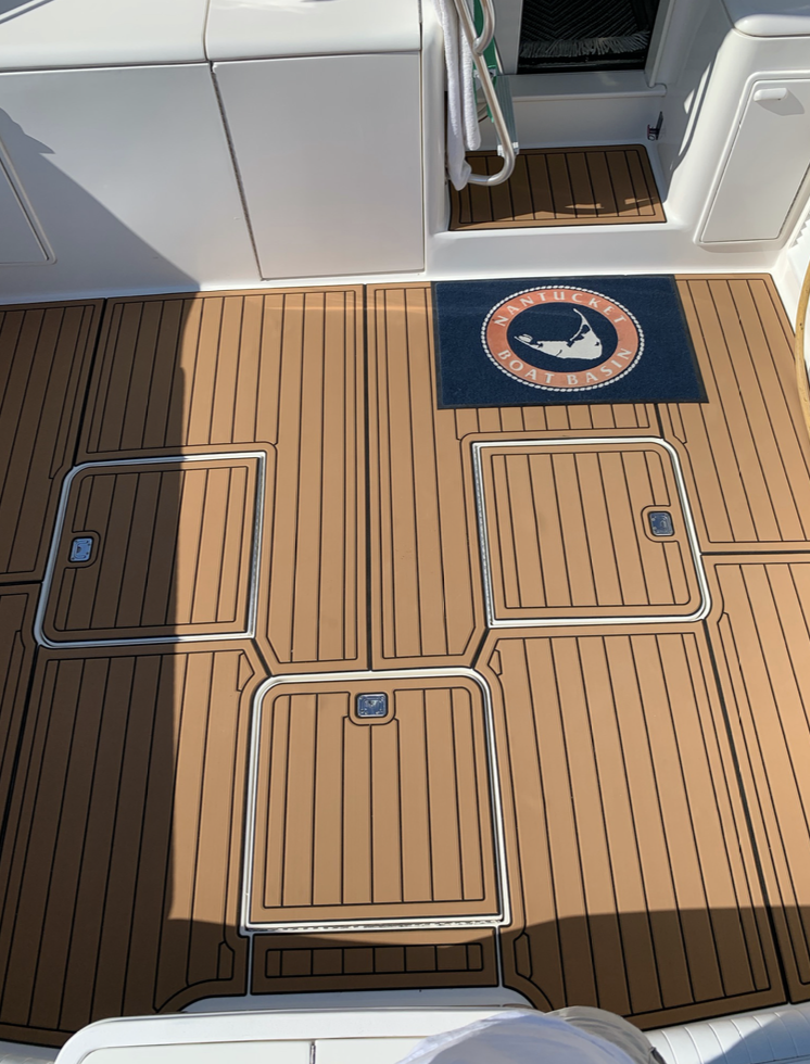

    Update - I roll/tip Awlgripped the swim platform and it's a 10/10. For the cockpit I decided no paint. Ended up installing synthetic teak up and down -- and very glad I did. The material is amazing.. stays cool, clean, great traction and doesn't stain. More expensive than a DIY Awlgrip job, but well worth it for me

    Wow that came out great!! Nice job. Did you make a template and send it in to have the sections made? Sea Deck ? When you say top do you mean the bridge? Any pics?

    I used Aquatraction. Professional installer built a laser template and drafted a CAD. Everything lines up perfectly. Pic of the bridge deck is too big to upload here

    Yours looks like a great fit.
    Like anything, it's all in the preparation. If they rush the scan and take too few points , you'll get a lousy fit. My boat neighbor had his 54 Carver done . It's horrible, quite frankly I would have rejected it .

    It does look like they did a very nice job and is a very nice color.
