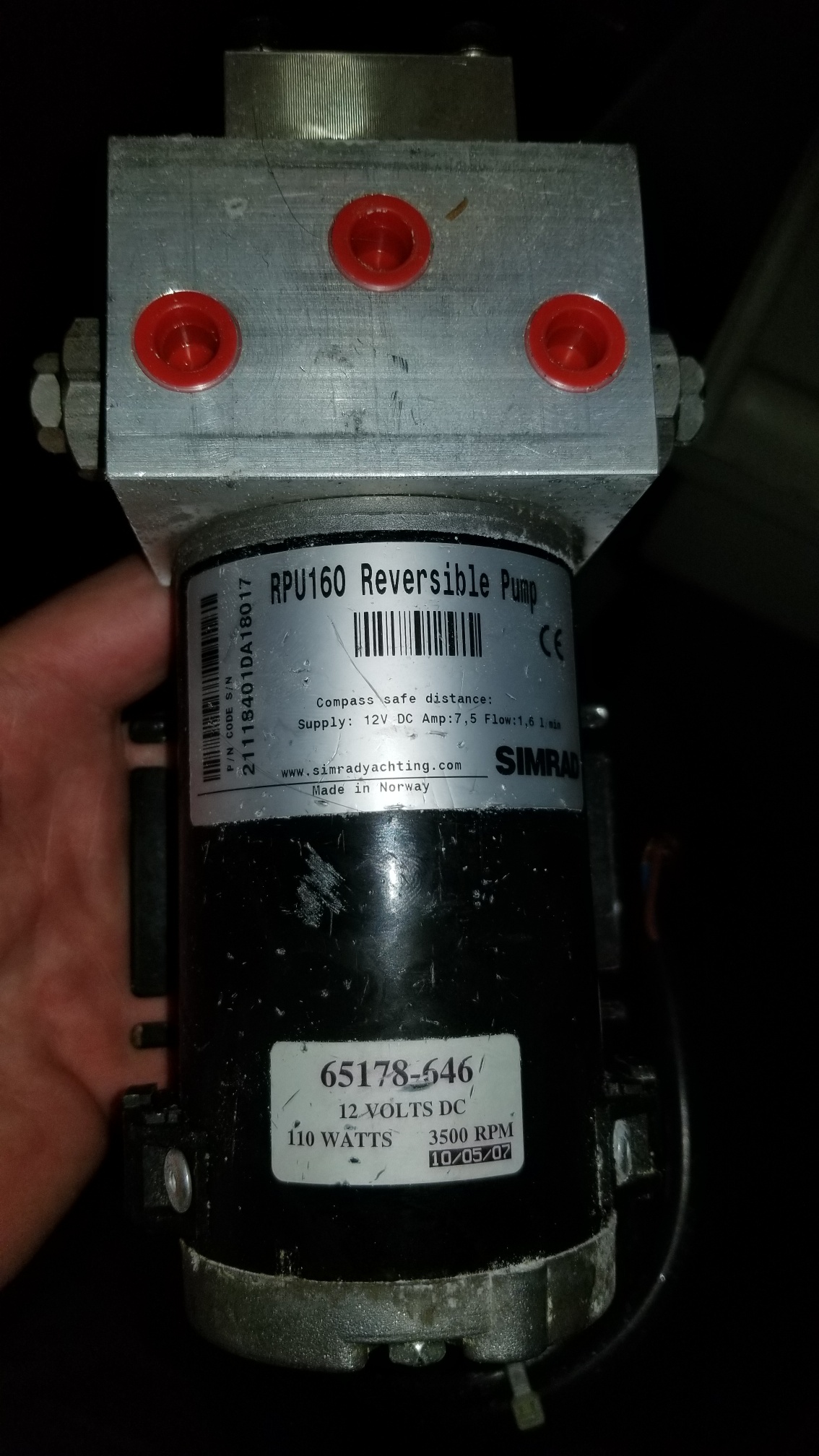

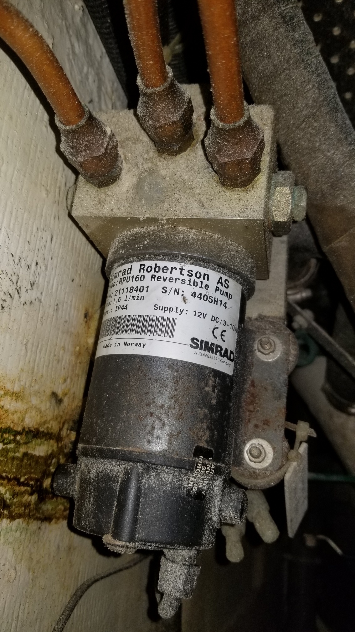

    I finally squeezed myself back into the space where the AP pump is located and found that it was 12V, not 24V as I had previously told Dockmaster, so unfortunately I won't be able to take advantage of his incredibly generous offer. However, I did find a new AP pump in the mess of spares that came with the boat, so I'll be swapping this new one in as I flush and rebuild the system. I expect that I'll get the rebuilt helm wheel pump back by the end of this week.
    Old pump (I wiped a lot of dust off the label for the picture... I suspect it hasn't been touched since it was installed in Taiwan 20 years ago):
    New pump:
