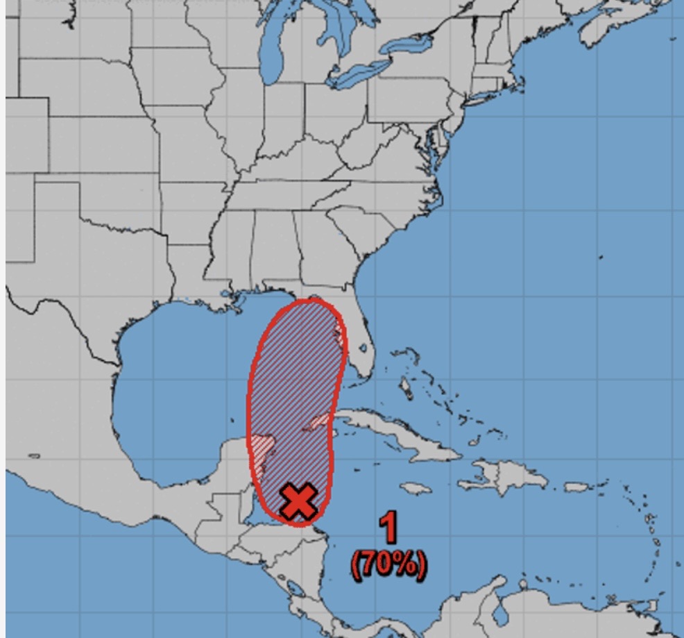

    Start watching the weather for were you plan to be Wed-Fri there could be a tropical storm crossing the state of Florida anywhere from Tampa Bay to big bend area coming out around Jacksonville into the Atlantic and up the east Coast.

    We’ll be in Ft Pierce. None of the marinas I called heading north are taking reservations due to the storm. We can ride it out here safely. If we head north now, we might end up riding it out on anchor.

    That’s the right call. It s too early to know how far east it’s going to go. These storms coming out of the western Carib are always tricky but we usually don’t see them until later in the season. This is supposed to be Cape Verde season. Go figure.
    plenty of hot water ahead although there is still a bit of shear as well.

    Yup, something is brewing:
    Lots of warm Caribbean and Gulf waters to feed this thing and make it a monster.:eek:
