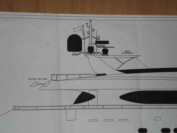

    IMO, theres too much weight, too high up on too small a footprint...I'd be concerned with the continual leverage this arrangement will transmit to the mounting points on the hoop top surface. Scale wise, those vertical tubes look more like 3" dia, but I'd go for 4" dia low down and try to spread the feet out wider. You may get quite a bit of vibration through this arrangement too, resulting in a pronounced wobbling of the very top end. It just looks very tall and skinny for the weight its carrying.

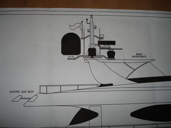

    The mast shall be constructed by 3" tube. Many thanks for your kind reccomendations

    Err, perhaps that drawing is just not filled out yet? But as it appears now, I'd say the concern from CODOG still stands - "too small a footprint".

    Looks like a very different mast. I would once again be checking over the specs on all equipment to ensure you do not have issues resulting from proximity to other equipment.

    The last pictures are obviously not to scale and rather pictorial...totally different arrgt from the original. So, if this is the revised arrgt, its almost impossible to comment as to the aesthetic or structural aspect due to the sketchiness of it all ? I'd now be worried by the practicality of cable entries and servicing of the various items, with the aparent lack of space between each item and the extremely thin mounting platforms for each item...access to the underside of the domes, hingeing the radar covers back etc etc (radar antennas hitting the structure) :) Please tell me this isnt a build drawing from the yard ?

    I am sorry indeed its a different mast, I have uploaded wrong pics

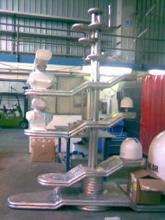

    The mast is now under construction upon delivery i will keep you posted with new photos

    The finished mast
  13. comship
    comship Senior Member
    Jan 27, 2007
    174
    Greece
    trial installation of equipment
  14. NYCAP123
    11,209
    I'm neither a designer nor an engineer, but let me suggest that you move those horns to where the won't deafen everyone on the upper deck. Beyond that, wow what a crowd. No cross- interference or blocked signals?

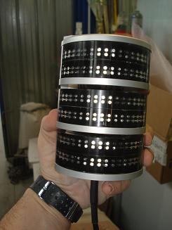

    As somebody can understant the shipyard trial install now the equipment in order to plan the cabling.
    A cool feature of the mast are the LED navigation lights made of titanium
