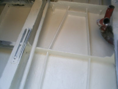

    You only saw one
    Don't judge all steel hulls by just seeing one. He is photo of the inside of my steel Roamer Offshore.

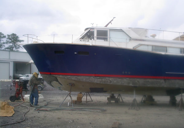

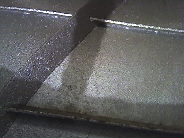

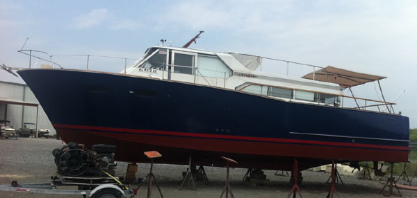

    Inside hull: after treating rust spots with NAPA Duro Extend Rust Converter, two-part epoxy industrial pipe/tank paint from Sherman Williams replacing
    "...and the silver hull coating is a tar-like substance called .... bitumen that was painted silver after it was applied. It's great stuff, but degrades when soaked with oil and/or submerged. I would recommend ....... roll on a few coats of Devoe 235 epoxy primer being certain to leave no voids." (from q240z in 2010)
    Outside hull after sandblasting: 6 gal. Interprotect Barrier Coat, 3 gals. Micron CSC red bottom paint, magnesium anodes.

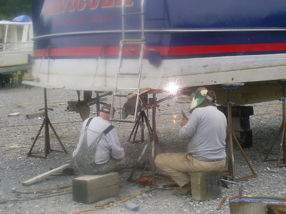

    Same $$ as previous sailboat
    How steel boats fix blisters:
