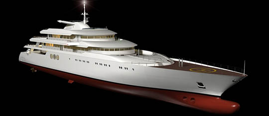

    ArchNav 80m MegaYacht - High Detail Model
    Specifications...
    Loa = 84.8m
    Beam = 14.8m
    Draft = 3.6m
    Construction = steel
    Speed = 18.0kn
    Engine = 2x2500kw
    Propeller = 2xcontrollable pitch
    Rudder = 2x
    Bow thruster = 2x
    Guests = 14
    Crew = 20

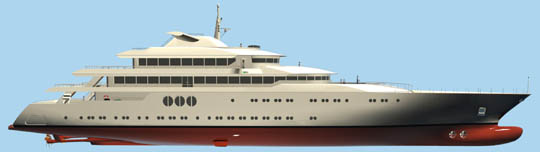

    80m sideview rendering -
    The lower deck accommodates engine room with the crew quarters at mid ship and last but not least a heli garage (forward). The main deck accommodates the two main tenders in aft position; guests staterooms at mid ship. The technical foredeck is enclosed. Hatches can be opened to access the heli lift (forward)
    The second deck accommodates lounges for owner and guests (aft), the captain's stateroom (centre) and the very special round and panoramic pilothouse (forward). The third deck is the owner's quarters.

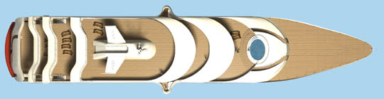

    20,694
    Top View Rendering -
    Extensive outside deck areas allow commanding views from any location. The forward mounted pool can be clearly seen in this rendering.

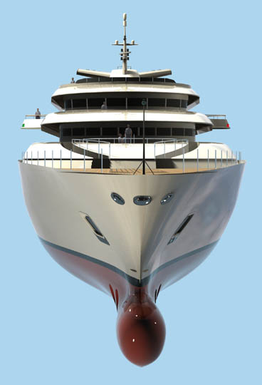

    20,694
    Front View Rendering -
    Features include extended control station balconies for line of sight maneuvering and full forward views from the upper decks.

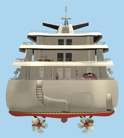

    20,694
    Aft View Rendering -
    The staggered aft decks allow unobstructed views astern, from any level. Stairways to port and starboard grant quick access to each level.
