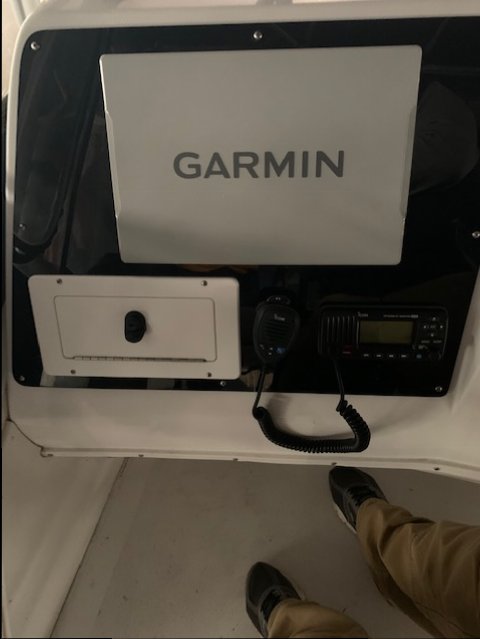

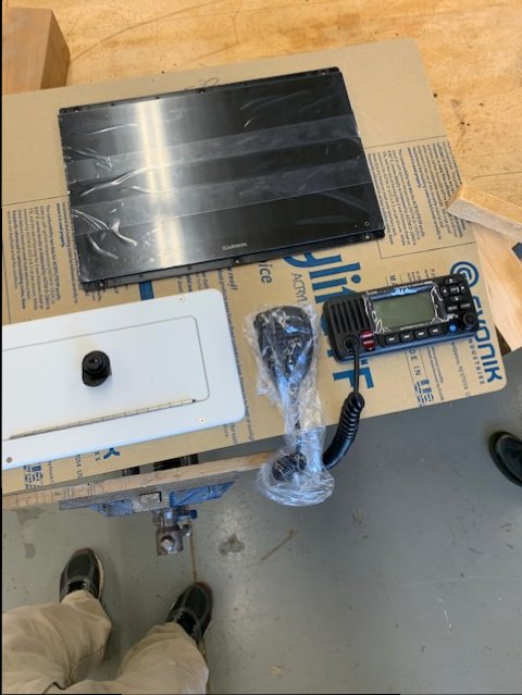

    Cut my acrylic on Saturday. I will post when its done. Putting in 16" Garmin, Icom radio and a glovebox to make up for the zero storage the helm has.

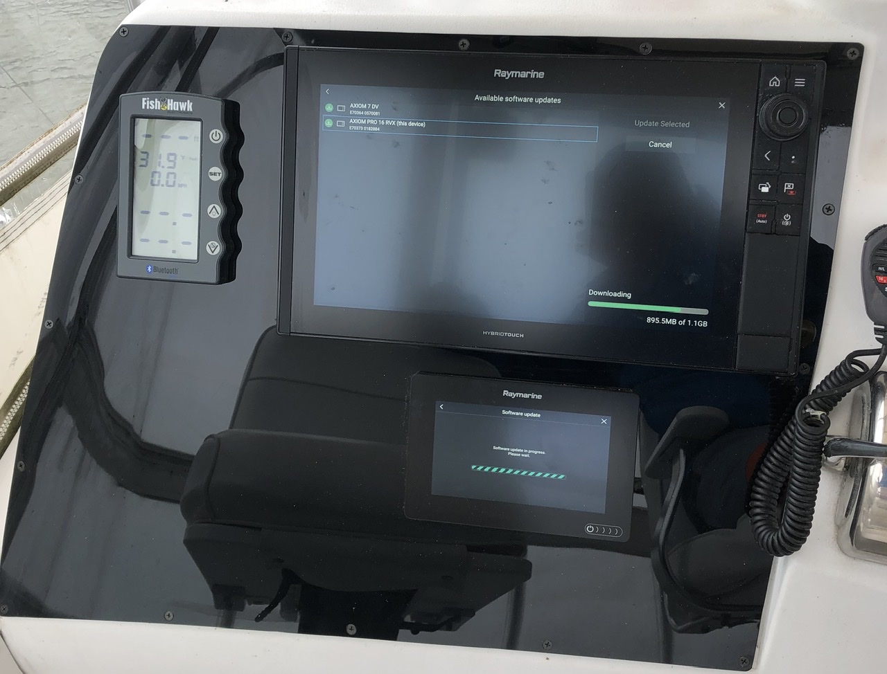

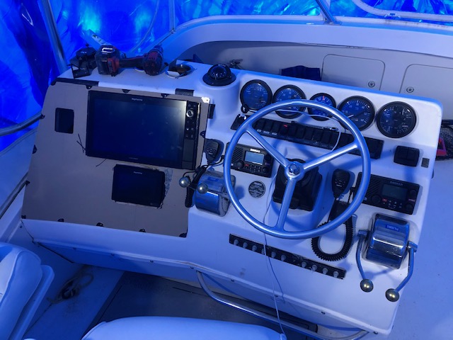

  3. Josh Keeran
    Josh Keeran Member
    Feb 10, 2020
    62
    Chicago/Racine,WI

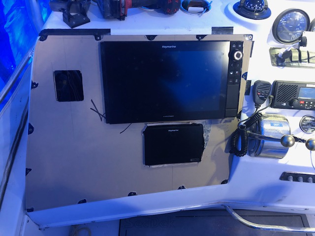

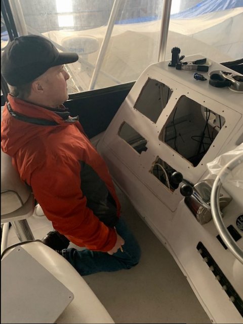

    Progress report!
    still working on it but started dry fitting the panel and electronics. Now that I’m happy with the end result I need to re-enforce the original helm behind the acrylic panel.

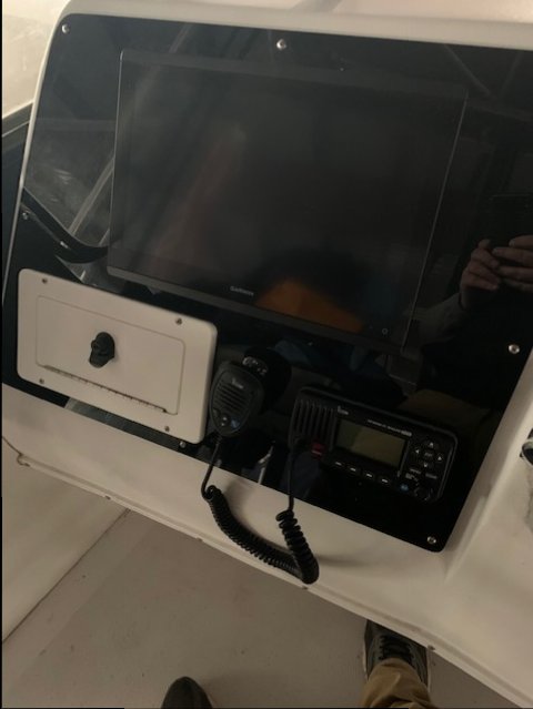

  5. Rich Plukas
    Rich Plukas New Member
    Feb 10, 2020
    28
    Rochester, NY
    Laid out and cut my 1/2" black acrylic for left side of helm. Added a small glovebox for sunscreen, sunglasses odds and ends you always have.

    looks great Rich!

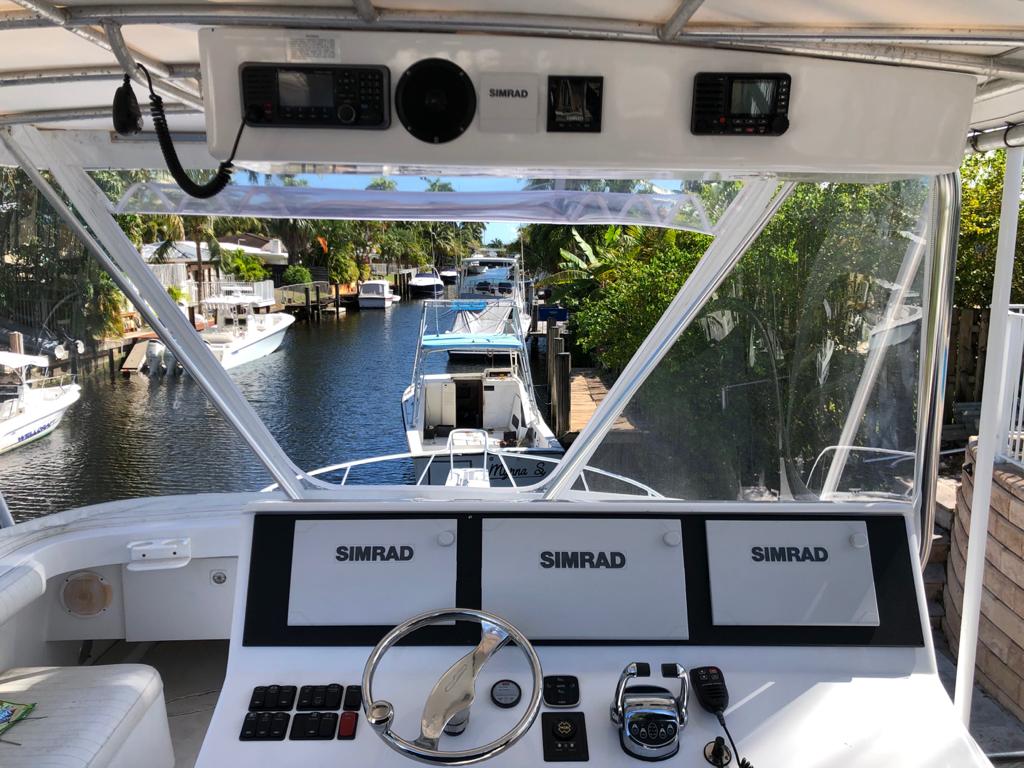

  8. electro
    electro New Member
    Jun 12, 2016
    4
    ft lauderdale

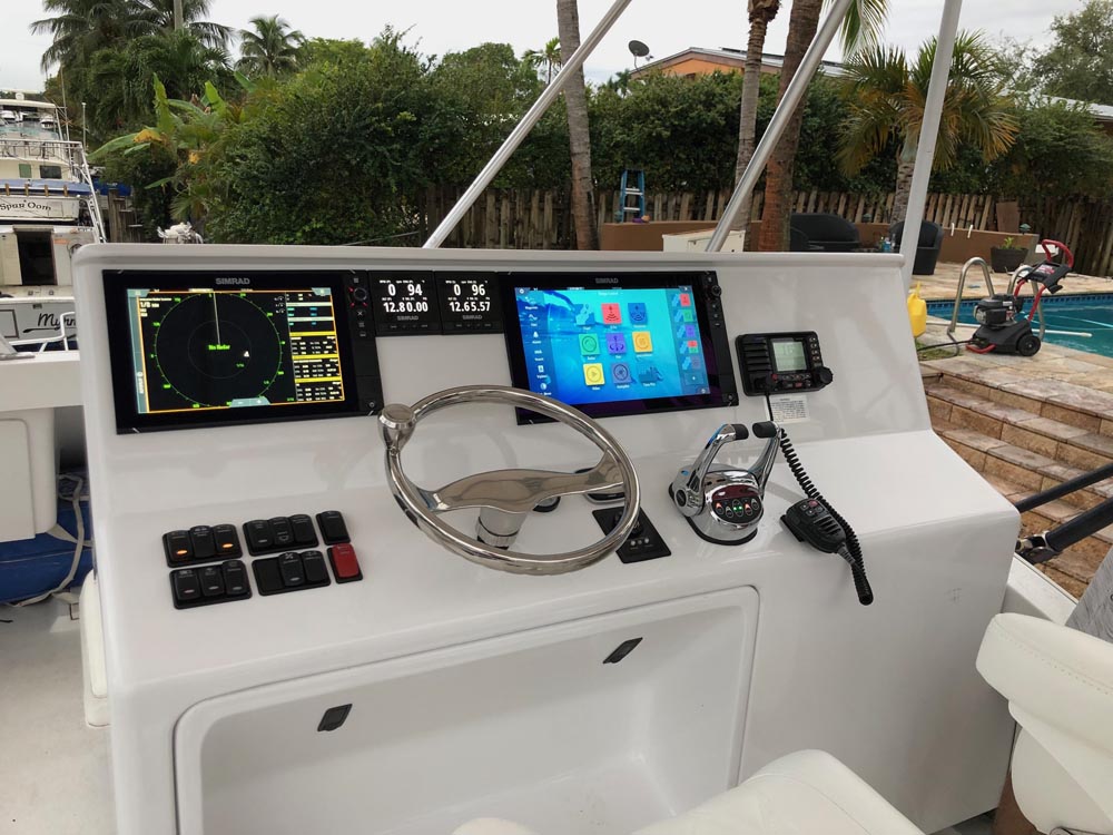

    This is what I've done on my 1999 40 convertible.

    This is another pic before I added a third MFD and a black insert and rearranged things a bit

  11. Rich Plukas
    Feb 10, 2020
    28
    Rochester, NY
    Wow! Looks very clean Electro. Nice job.
  12. Josh Keeran
    Josh Keeran Member
    Feb 10, 2020
    62
    Chicago/Racine,WI
    I love it! That would be my end game to re-do the entire helm pod. I imagine quite a few man hours are in that project
  13. electro
    electro New Member
    Jun 12, 2016
    4
    ft lauderdale
    Quite a few, but most spent on trying to figure out the dimensions. I had to fit it without taking the soft top frame off the boat. I used google sketch up program, the free edition and did a rough mock up from cardboard. Other than that it’s straightforward 3/4 inch plywood covered with 10oz and epoxy. Had to take it to a paint shop to have it sprayed.
  14. electro
    electro New Member
    Jun 12, 2016
    4
    ft lauderdale
    If I had to do it again I would use 1/2 inch ply instead
  15. Rich Plukas
    Feb 10, 2020
    28
    Rochester, NY
    Finished the helm work this weekend in the cold, damp barn. Fishhawk will go on the top left. other cords will be removed and holes filled. Hoping launch this week.

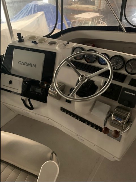

  17. Josh Keeran
    Josh Keeran Member
    Feb 10, 2020
    62
    Chicago/Racine,WI

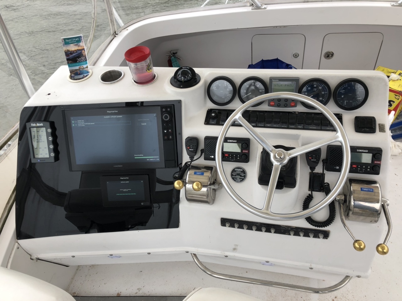

    Finally finished up my dash! Funny thing ya Richard and I talked a few months ago and just happen to be doing the same thing without knowing it! I like his idea of the glove box. I plan on replacing my 7” Raymarine unit with a 12” unit down the road so I’m going to leave mine as is for now. I also did decide to remove the electronic compass from the middle above my wheel and replaced it with my autopilot head unit.

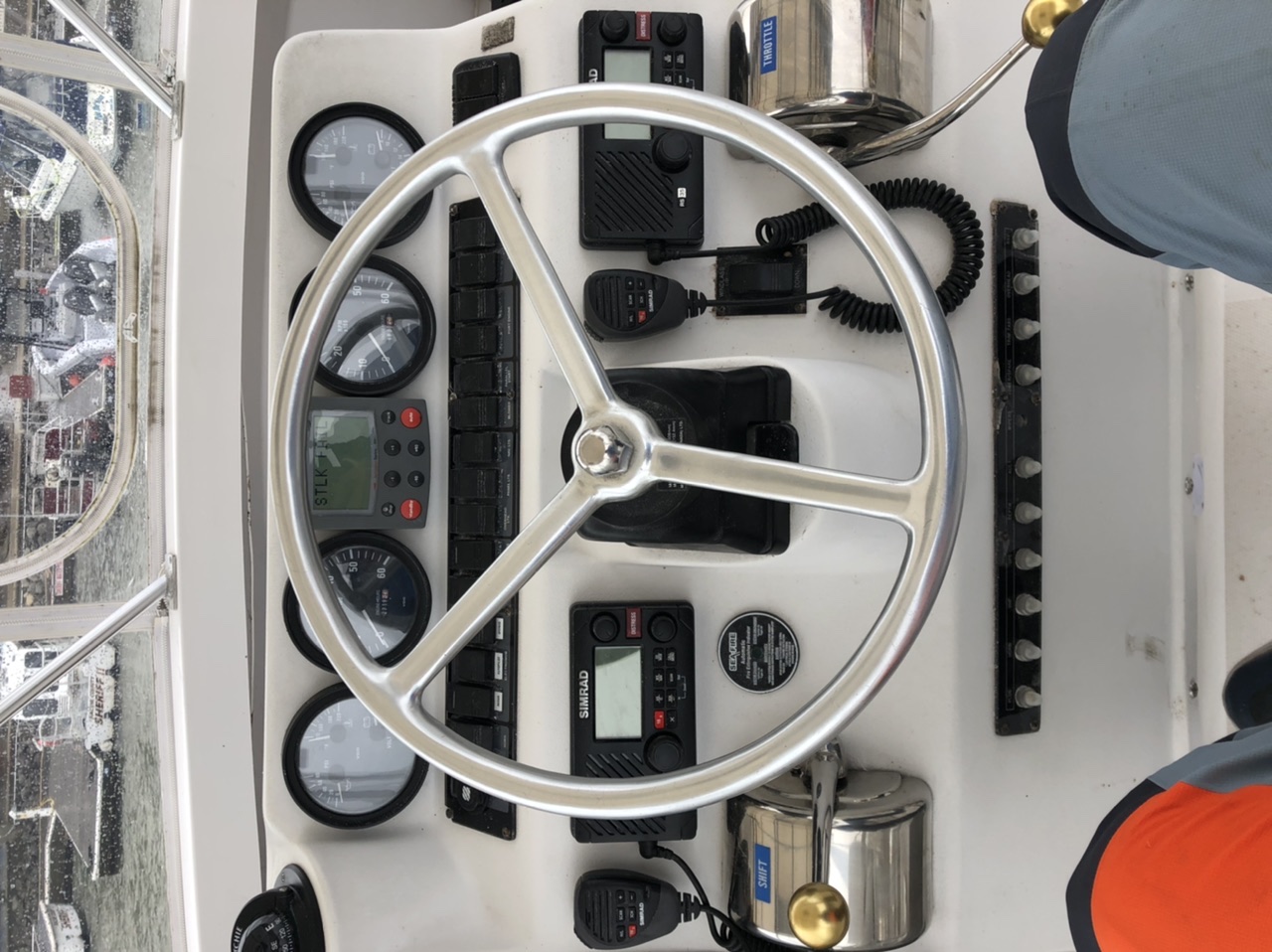

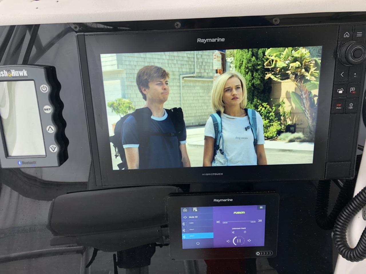

  18. Josh Keeran
    Josh Keeran Member
    Feb 10, 2020
    62
    Chicago/Racine,WI
    Couple more pics......Also Raymarine now has an app for Netflix! No more “back dooring” the software!

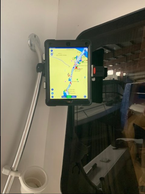

  19. Rich Plukas
    Feb 10, 2020
    28
    Rochester, NY

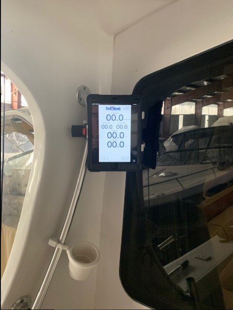

    Looks awesome Josh! What is the 7" screen for?
    I have also bought a removable mount to send my screen down to the fish deck. Can either mirror the Garmin or get my Fishhawk numbers via Bluetooth.
  20. Josh Keeran
    Josh Keeran Member
    Feb 10, 2020
    62
    Chicago/Racine,WI
    Well, after not believing Raymarine and finding out the hard way by blowing up the sounder board of the 16” Axiom Pro unit.....the particular Raymarine thruhull transducer that was on the boat is compatible with an Axiom unit but not an Axiom Pro unit. Either needed a CP370 sounder module or a regular axiom unit. Instead of using a separate sounder module I found a used 7” Axiom unit relatively inexpensive. It works great as a remote for the Fusion stereo mounted in the cabin as well as second display.
    what mount did you use for your tablet? I have the exact same plan for my fish hawk! I like the Seasucker mount but not sure about $100 just for a mount
