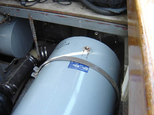

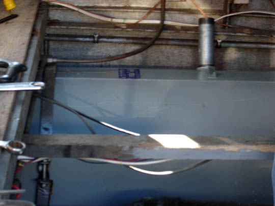

  5. alloyed2sea
    alloyed2sea Moderator
    Jan 28, 2004
    872
    Alex, VA
    First things first?
    When replacing my galvanized steel tanks (40 years later) wanted gauges as well. Had to order tanks with built-in SENDING UNITS. Regular tanks do not have them. The sticks never LIES however.
