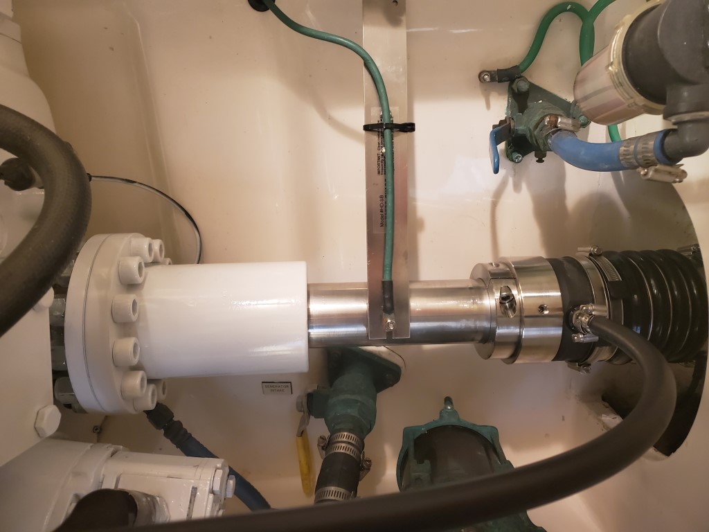

    That clean. Cold water and stored under cover so lots of shade. Back of props get some growth as does back of transom from light coming under door.

    All good.
    I hate shaft log cutlass bearings..
    I remember working on some couplings after other shops did a supposed alignment;
    Please keep note that Island Packet power cruisers and ole Striker yachts have a cutlass bearing in the shaft log.
    You must really move an engine around with a wet toothpick to get that coupling properly flat.
    I learned a lot, the hard way, working on my best customers above boats to get them rite.
    When a shaft log bearing is used, ZERO tolerance must be achieved on alignment.
    Never under stood the need or headache but they were there.

    'Salright, but are you positive that there shouldn't be one?
    I've seen boats with an identical shaft thru-hull setup, but with a bearing inside it.
    How close is the gearbox coupling, from that point?

    Not sure the exact number but the distance is pretty short. Can't imagine that not being how they all came from factory.
  5. Capt Ralph
    14,578
    Dammmm, that is a pretty picture.
    No need for a bearing in the shaft log there.

    Agreed, considering the very short distance.
