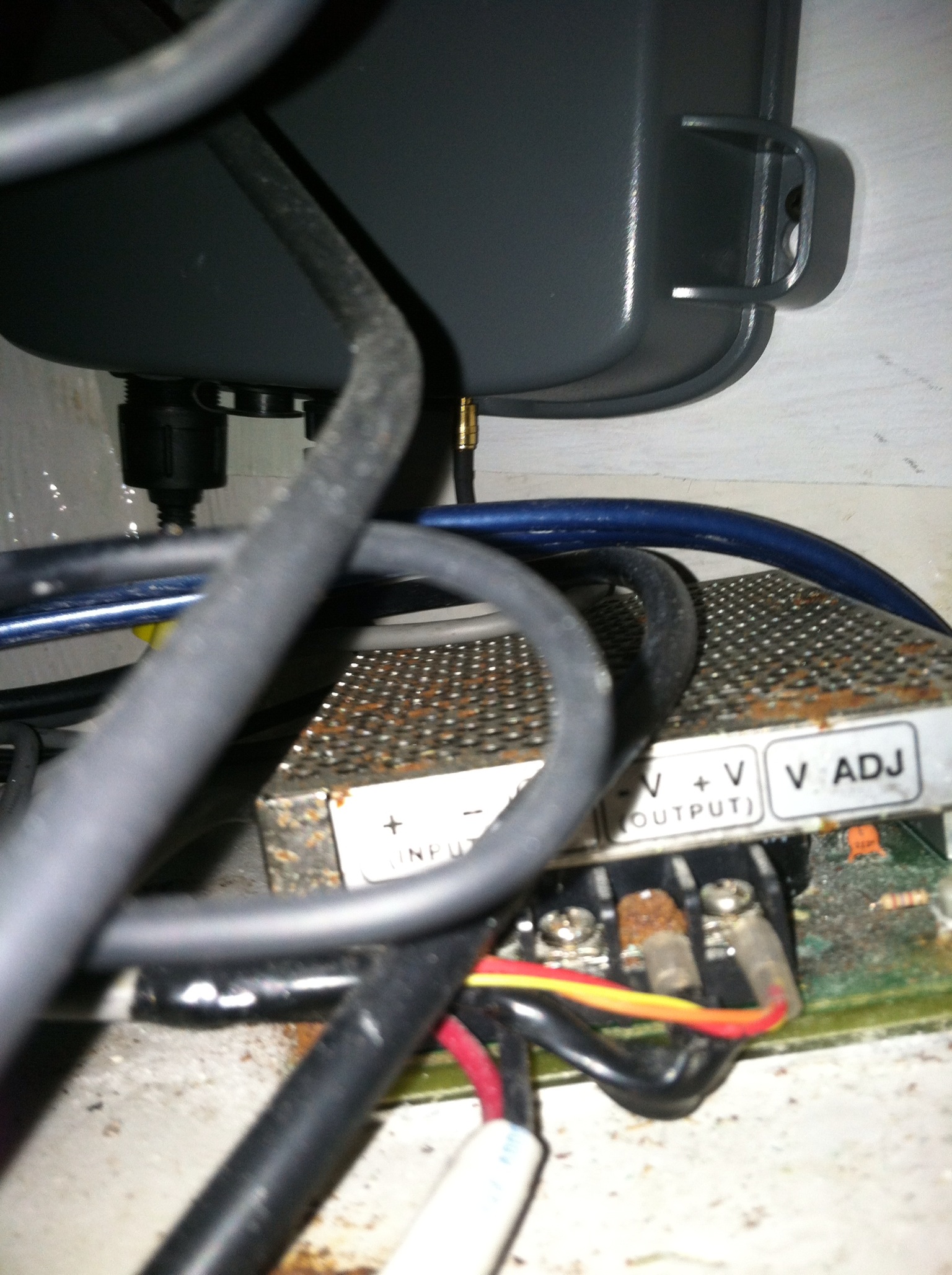

    This small box with the rusted, hole vented cover is way deep under the instrument panel. Obviously has some corrosion issues but I have no idea what it is or what it does or if it's still working. Anybody recognize it? I was able to stick one arm into the hole it's in to take this picture. I hope it's not important cause it would be a ***** to try and get it out of there to clean it or replace it.

    Looks like a DC to DC power supply. Probably either 24V to 12V or vice versa, could be 12V to 5V ... trace the wiring.

    Looks like some converter. Check voltage on input and output terminals and trace teh wiring to see what it does

    Easier said than done! It's buried pretty good but I'll look again. So it's changing DC voltage for some component that needs something other than the 12volts supplied, interesting.

    You have a electronic componant right above it, probably part of your GPS or VHF. Plus this is also an after-market item. It has to be accessable, and it's probably easier than it looks at first glance. I'd guess you can either remove a panel on your dash or the whole helm with a few screws, or there's a panel that opens behind it in the cabin. Everything that goes in can come out. I agree it's a DC voltage step-down. If all your electronics, spotlight and windless are working so is that. So a I wouldn't consider getting to it a high priority.

    I was a bit baffled by that statment also, sometimes it's prudent to look at the time posted and write it off to a bad hair day. In no way have you scolded anyone on this forum . The box your asking about is either a AC to DC converter or a DC to DC inverter . See if you can find a nomenclature plate on it for input and output voltage or use a VOM to ascertain input and output voltage.
