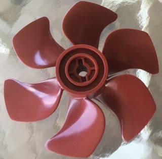

    Splurged on a new prop for my Vetus thruster: Plenty of growth in my brackish canal, both barnacles and slime.

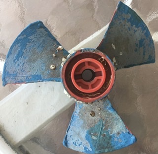

    Used regular anti fouling paint before, with mixed results:
    Thruster and boat is being used at least once a week come hell or high water.
