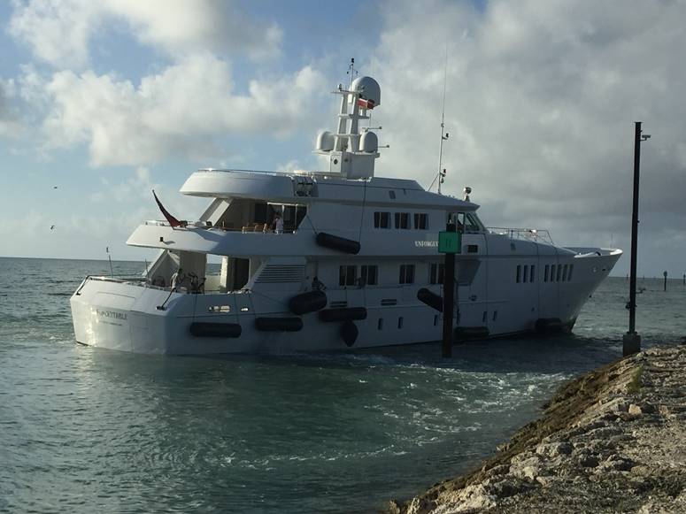

    This incident on Safira isn't an isolated failure of Schottel's SRP / Rudder Propeller Azipod Drives on yachts. A 42 meter Royal Denship named "Unforgettable" has been bouncing off of docks and seawalls around the world for some time now. Plenty of articles and videos out there of this yachts propulsion equipment failing during crucial times. This photo is Unforgettable losing azipod control in the entrance channel at Albany Marina in Grand Bahama in 2015. In 2009 she went in uncontrollable mode in the inner marina basin at Lyford Cay and finally wound up on the rocks in the main entrance channel. The video of this incident is hard to watch where the Captain is struggling for control and the damage being done to nearby vessels and then the final indignity of being up on the Cocina coral entrance channel shelf. She sat in Bradford Marine for over a year and a half while Schottel wrangled over the fix and refused investigative service making the vessel all but unsellable in the marketplace. Once the lawsuits settled , Schottel had come aboard and installed two new units in the vessel with new harness's and control systems Problems then stopped.
