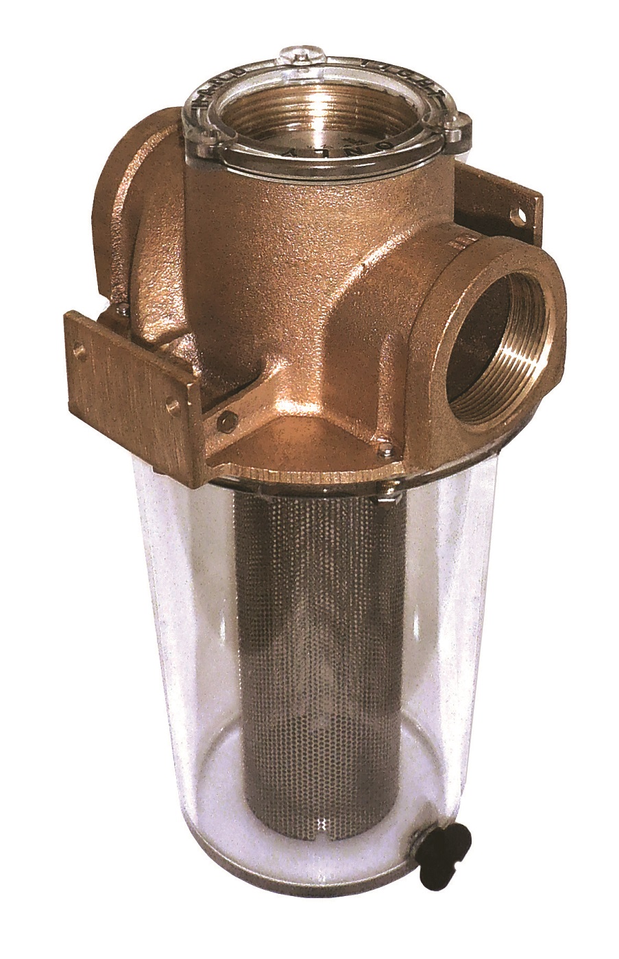

    I'm very surprised the OP doesn't have those strainers on his Ocean. Wonder if a prior owner removed them. Sucking up a plastic bag into the raw water side ain't good. Whoops, just read post #41 - he found them.

    Has anyone put in a sea strainer in the line to the seawater pump? Or perhaps a sea chest to service both engines?

    Buck makes strainers like in line fuel filters. Called low profile.
    Sea chest usually have a screen or circular strainer built in. An extra strainer outside the chest would not go to waste capturing extra silt.

    I did add strainers after the seacock on my Egg. It also made winterizing much easier.

    I kept the scoop strainer on when I added the inboard strainers.
