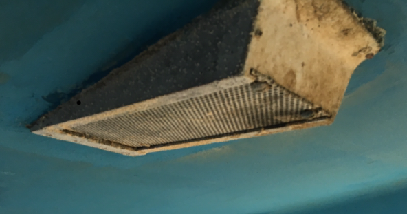

    I was wrong! I do have the external strainer just like yours in the picture. How do you clean it out?
  2. alvareza
    alvareza Senior Member
    Aug 20, 2010
    160
    Scituate MA
    When the yard was prepping for bottom painting they removed the screen and blasted it in their shop, not sure if they used sand or something else for the blasting media. I think The screen slides out after a couple of screws are removed.
  3. C team
    C team Senior Member
    Nov 1, 2011
    257
    Kent Island
    Yep, Ocean, Post and Egg Harbor all used the same external strainers.
  4. C team
    Nov 1, 2011
    257
    Kent Island
    I my Egg, there were screws going around the screen where you can remove and clean the "cheese grater".
  5. praetorian47
    praetorian47 Senior Member
    Aug 22, 2011
    257
    Bayport, Midland, Ontario
  6. C team
    Nov 1, 2011
    257
    Kent Island
    Yep, from the picture, it does look clean. Once the screen is out, you can look up into the seacock and see if it is fully open as well as check for any blockage.
  7. praetorian47
    Aug 22, 2011
    257
    When flushing the engine, am I flushing the coolant or the fresh water side, or both? Any advice on that? I'd like to start that next week if possible (I may still have water in the building then which would save me hauling buckets up.)
