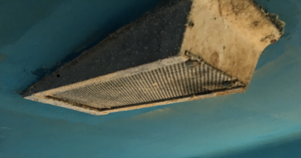

  19. alvareza
    alvareza Senior Member
    Aug 20, 2010
    160
    Scituate MA
    Picture of the external strainer for the engine on my Ocean
  20. praetorian47
    praetorian47 Senior Member
    Aug 22, 2011
    257
    Bayport, Midland, Ontario
    I'm pretty sure I don't have one of those.
    Maybe I do t have one at all?
