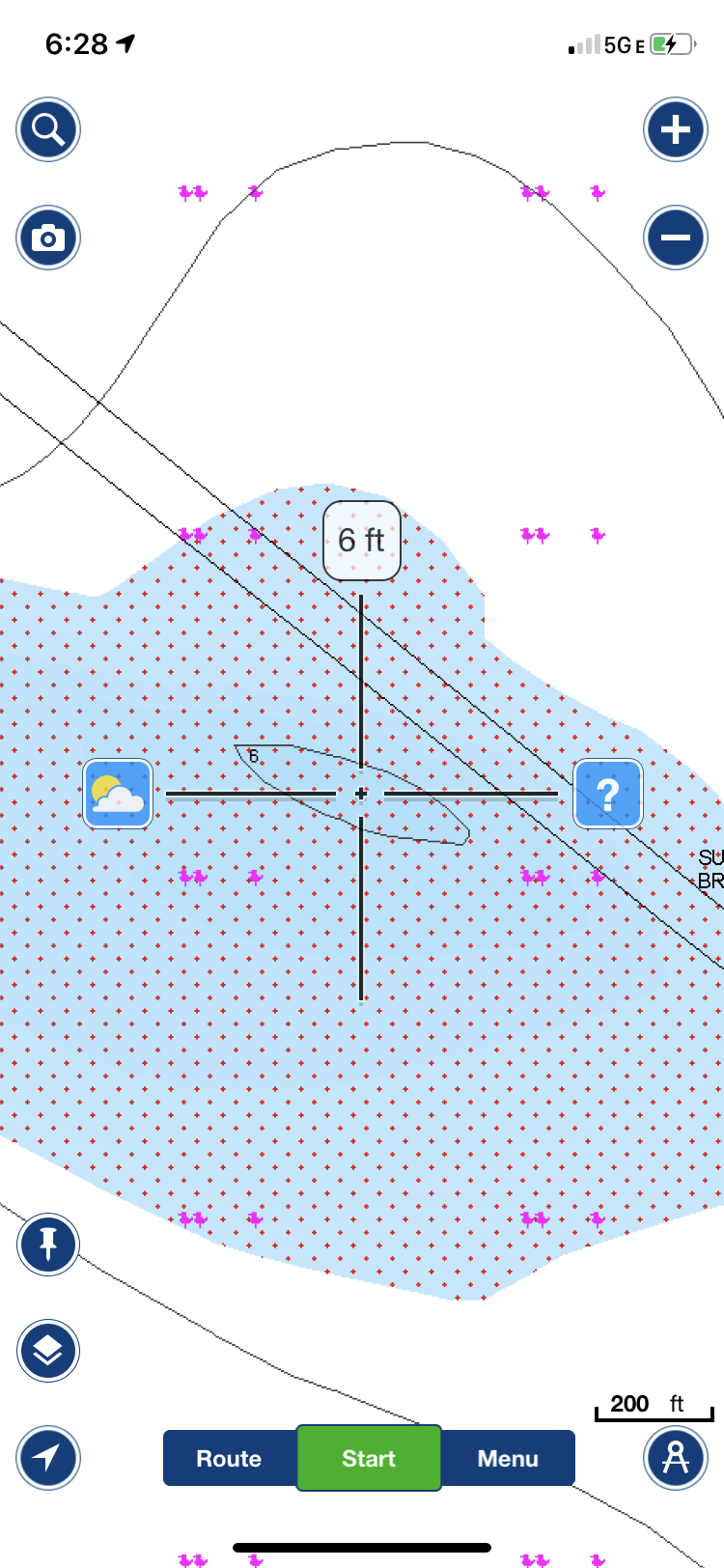

    Hmm...I’ve gone in and out of there quite a few times.
    Plus cut over to Hilton Head often.
    Always stayed away from the jetty. But if you look at the chart on say Navionics, it shows nothing but 12-14 of water over most of it.
    There is one area that shows 7-8 over the jetty and 6’ around it. I wonder if that’s were he hit?
    So I can see how someone could possibly be lulled into a false sense of security about going over it.
    Especially if they don’t zoom in on the chart.
