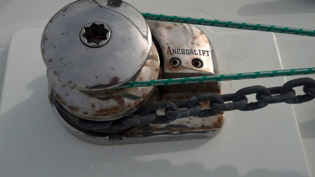

    I wanted to warn everyone about a bad experience with Anchorlift windlass warranty and support.
    In June 2013 I purchased a new, in the box Anchorlift Dolphin 1012C Windlass on ebay from ebay seller Gulfstream Marine in Clearwater, Florida. All went smoothly with the transaction and delivery. I had the windlass professionally installed in July 2013. Now, three months later the windlass is getting quite stained with rust spots. The construction is reportedly 316L stainless, which should most likely not get rusty in 3 months (on the upper Chesapeake - in nearly fresh water) The boat is kept in a covered shed slip.
    Anchorlift says: 5-year factory warranty applies only to products purchased through authorized ANCHORLIFT dealer. This was a reply from "Roy" their technical manager in Norway.
    I can't seem to find any "authorized" Anchorlift dealers in the US except their own USA office in Largo, Florida. Their website offers a phone number which goes to voicemail, and a "yahoo" email address which no one seems to check. There is a note on their website that states: Please check back soon for more convenient purchasing options.
    Gulfstream Marine says: This unit was sold discounted and without warranty as described on ebay. I use to represent anchorlift as a dealer before anchorlift decided to import their products directly to the US. Sorry, I couldn't be more help but there is nothing else I can offer you.
    Original ebay listing (still available online) makes no mention of there being no warranty.
    BUYER BEWARE. Here are photos of the 3 month old rusty Anchorlift windlass.

    The flip side of this that some of us can only afford to buy these products from Ebay. The Anchorlift windlass is a dynamite product and it is affordable. The only way that the windlass pictured could have rusted like that is from applying On-Off or some other mild acid solution while cleaning the boat. I have never seen 316 Stainless develop circular rust spots from normal seawater.
    You buy a product from Ebay for the price. If you need a 5 year warranty for a windlass then you have to pay for the warranty. Of course a suit from Norway is going to disparage an Ebay seller since they are cutting into his bottom line. At the very least this forum should be labeled "misleading complaints about a great product".

    But you have to consider the whole story here if you are going to take sides. Look at the photo and tell me if you have ever seen 316 stainless steel corrode like that from normal use. You cannot blame a manufacturer after careless mistreatment of the product. I am not a dealer. I buy and sell marine products.

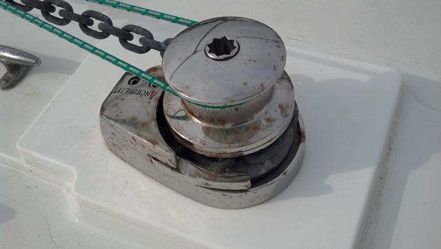

    The Anchorlift windlass in the photo was three months old at the time. The boat is kept in brackish water on the upper Chesapeake Bay IN A COVERED SHED boat slip. This particular Anchorlift windlass was not mistreated, it was not even left out in the weather, it was NOT touched with chemicals - ever. I have since polished it with NevrDull to try and remove the rust, but the rust keeps coming back. It's clear enough that there is some "316 stainless" that is anything but. I'll post a few more recent photos of the subject Anchorlift windlass. As of now, it's still on my boat.

    Edit: Here are a few photos from last season. The condition of my almost 50 year old boat makes that rusty Anchorlift windlass look even worse. I'll get some current close-ups of the windlass and post them here.

    The fact that it has rusted like this must surely raise the idea in even the most biased of supporters that maybe the shiny stuff they see is not what it is claimed to be.

    It seems clear Sea Eric purchased a cheap China copied knock off from E Bay. China has no rating system for stainless i.e. #304 /#316 etc. Stainless means "Stains Less" in China. As a professional I have procured & installed 5 Anchorlift products over the past 6 years all from Port Supply, the contractor segment of West Marine, every unit to date looks & performs today as they did 6 years ago. Unlike Sea Eric the systems we installed live outside & no cover. So far Anchorlift products have proven to be a lot of bang for your $ & rival the looks of Maxwell, pull just as strong & draw less amps for a lot less $.

    So, I'm curious to know: The Anchorlift windlass products that you purchased through Port Supply - Where were they produced? If not in China, then where? The one that I purchased off ebay sure looked like the real deal, ie packaging, paperwork, etc. If it wasn't genuine Anchorlift, then they went to a whole lot of trouble to make it look like it was. I even ordered the Anchorlift wireless remote at the same time from the same ebay vendor. It all looks authentic and I guess it works ok as intended. It's just a crappy quality finish IMHO.
