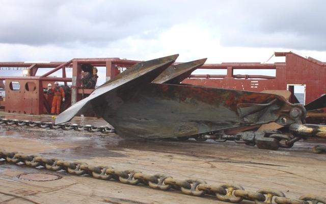

    " ... and they are quite large."
    Like this?
  7. Capt Bill11
    Capt Bill11 Senior Member
    Feb 27, 2006
    1,458
    Sarasota/Ft. Lauderdale FL
    Yes. And it looks like even the oil industry has moved on from the Bruce.

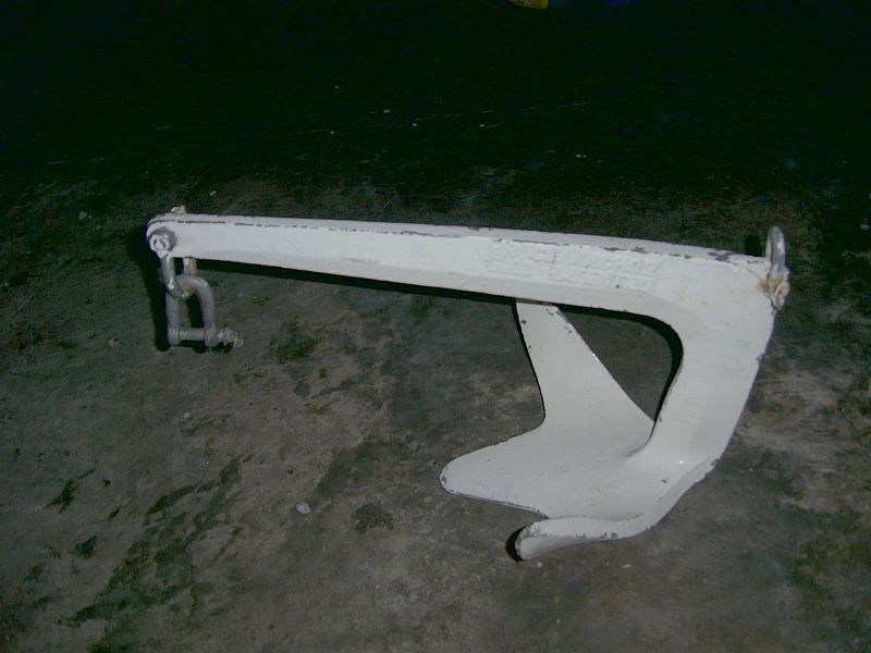

    How about this....
    More for the Aussie boaters than international as its made in Oz. The Sarca Excel - made in Victoria. I've used it in tough conditions off Kangaroo Island and found it to be remarkably good. I use all chain 12mm shortlink and don't use a swivel on the 50kg Sarca. Mine is all galv including the Sarca Excel. I "upgraded" from an Admiralty pattern anchor with which I had all sorts of retrieval issues. I have a 55' 25 tonne flybridge cruiser. I sleep well with ideally 7 times water depth of chain out (or more sometimes). And the price was good direct from the manufacturer.

    Posting #46 above is NOT a Bruce anchor, but I'm sure Marmot knew that.
    Bruce Anchor
    This claw shaped anchor was designed by Peter Bruce from the Isle of Man in the 1970s. Bruce gained its early reputation from the production of large scale commercial anchors for ships and fixed installations such as oil rigs. The Bruce and its copies, known generically as "claws", have become a popular option for small boaters. It was intended to address some of the problems of the only general-purpose option then available, the plough. Claw-types set quickly in most seabeds and although not an articulated design, they have the reputation of not breaking out with tide or wind changes, instead slowly turning in the bottom to align with the force.
    Claw types have difficulty penetrating weedy bottoms and grass. They offer a fairly low holding power to weight ratio and generally have to be over-sized to compete with other types. On the other hand they perform relatively well with low rode scopes and set fairly reliably. They cannot be used with hawse pipes.
