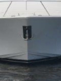

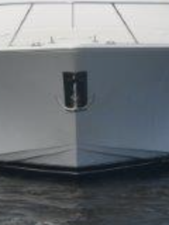

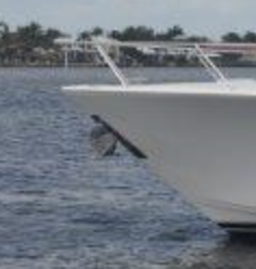

    Pascal - here are some pics. I will probably end up getting a yacht controller to help with docking and anchoring. In the past on a non-flybridge boat, I usually came out to the bow to bring the anchor up after we got it unset and most of the way in. I *might* be able to that again, but obviously a longer trek down to the bow. I don't run with a mate, just 2 and we are nimble getting around. One of my concerns with the sportfish is they are geared towards a bigger crew as opposed to a couple. I'm not opposed to a mate for a fish heavy trip, but for cruising we definitely prefer to go by ourselves.
    Screen Shot 2020-01-14 at 8.59.05 PM.png Screen Shot 2020-01-14 at 9.00.20 PM.png

    Looks like there is a roller already built in. All set
