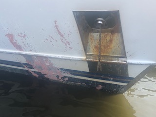

    Two days ago a motor yacht was offshore Hatteras heading for the Chesapeake in 10' seas when the thru the hull anchor deployed. Looks like it came loose 6-12 feet and just bashed up the side of the hull. Very ugly. Must have been going on for an extended period. She arrived in the Chesapeake with the anchor missing at the swivel on the chain. Aluminum coated in fairing does not like that.

    Fairing over the aluminum is at least 1/2" thick

    1/2" is pretty common. Unfortunately they too often carry that filler down into the bottom paint. That's a recipe for a mess...fortunately on this photo it seems that you could long block the section of hull below the rail and remove most of that from the wetted surface during the repair.

    Naw, That is not to bad. More embarrassing than damaged.

    I ran a 68' Chris aluminum Roamer. The only areas that never blistered were where there was plenty of filler. We had a complete paint and many blister repairs after, all on properly treated, etched, and primed paint. I often thought that the relatively thin layers of paint allowed micro-fissures to allow intrusion of moisture.
