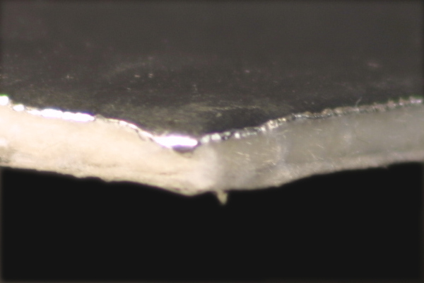

    Eric,

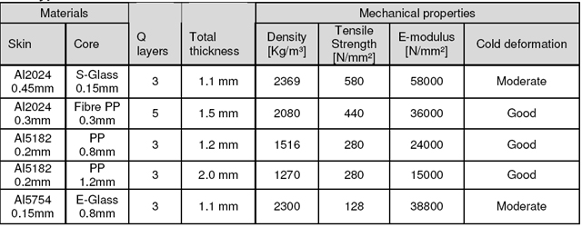

    Ofcourse Aluminium isn't "soft". I meant it relatively compared to fml's.
    I prefer an aluminium boat over any piece of plastic.
    It only looks soft if you compare it to this.
      79.7 KB

  5. alloyed2sea
    alloyed2sea Moderator
    Jan 28, 2004
    871
    Alex, VA
    Hmmm,..., I can read; BUT, (like our president) CANNOT understand (that fine chart):
    "Skin"?
    "Core"??
    "Q layers"???
    Sheesh - sounds like everybody already uses diagonally layered, composite aluminum strips (FML?) to build ship hulls -- COOL!
    Point is: Aluminum > GRP, eh?

    Eric,
    The projectmanager needed about two hours to get those figures cleared up for me.:D . It all looks like a bunch of hocus pocus but FML's are widely spread in the aviation industry and will soon be available for the construction of LNG tankers. Bottom line of the chart is that those numbers implicate the strength of the "sheets". Those numbers are an equivalent to 6mm thick Alustar (AA 5059 if i'm correct). You can imagine how much extra strength it has and how much weight can be saved. Effectively the target weight savings are 70% of a comparable aluminium hull. It's so stiff that buckling is virtually impossible.:cool:
