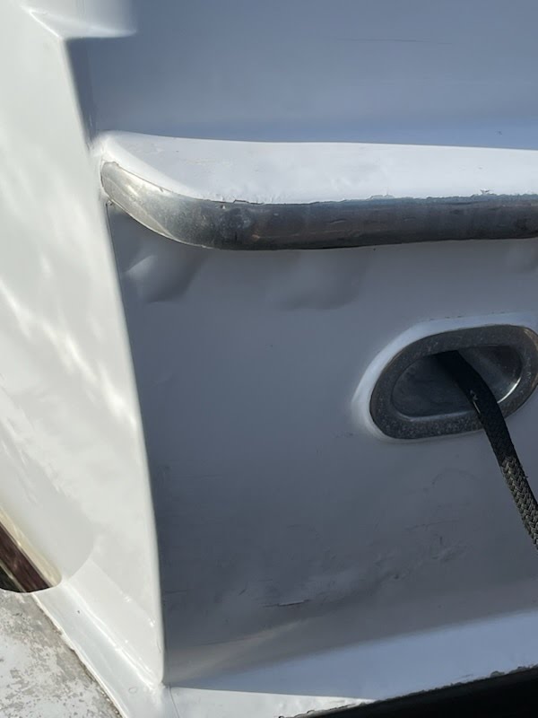

    Hey there,
    I know this is an old thread, but this seems like the right place to ask.
    I'm considering buying an older aluminum yacht and it has some bubbling above the water line on the sides of the cockpit. There doesn't seem to be any blisters on the main part of the boat, paint looks good from the aft deck forward. The swim platform is also chipped, but no signs of corrosion, I'm guessing it can be removed and repainted fine, but the blisters in the hull really worry me.
    They are pretty sizable, but not have not split open, so I can't see if there's white powder or not. It's just on the sides of the cockpit, about 3 or 4 half dollar sized blisters. I love the yacht, but don't want to pay (a tidy sum on a boat this size) to haul it out for a survey if those blisters are a good indication that the structure has been affected and I shouldn't waste my time moving forward.
    So, anyone with experience in older aluminum yachts, can you answer a couple of questions?
    Would this be an indication that the bottom will have corrosion issues?
    If it is Galvanic corrosion, about what does it cost to fix?
    And, will the integrity of the boat still be good or compromised after the repairs?
    Thanks for all the help in advance. =-)

    First,
    MFG and year is important is asking about alloy boats.
    We could use that hint as lots of us know what was used, when for lots of hull models.
    We know what hulls to avoid.
    Next, Your term Galvanic corrosion is used to often and mostly incorrectly; Stray electrical underwater currents remove less noble metals toward stronger metals, think Diode, while under water.
    The #4 post above is in error.
    This is not the case in this picture but still an important question for submerged metals (see below).
    This picture shows a paint/fairing blister that happens when moisture gets between the alloy and finish. Also if not prepared correctly on last paint job attempt. There will be a white jelly under that blister when cleaned out.
    I have worked on alloy boats 50 years old with minimal issues, then others with later finishes 2 years old worse than this.
    I would say this was fair to poorly re-finished within a few to 5 years. AND, will probably come back again.
    Think if your hand covers an area, each hand represents 3 hours of repair correctly, not including finish coat.
    I see 7 hands x 3 hours x $100 average tech charge. In your pic $2100.00 to CORRECTLY fix, not including final color cover.
    Did you just gasp??
    Now the bottom.
    Bottom plates require audio sounding.
    You hire a surveyor, He has a tech (You Pay for also) to clean many hull areas of paint and fairing and measures with his fancy audio sounder, how thick the bottom plates are.
    Plate starts at 3/16" to tin foil thickness. His report will tell you where these spots are (after you pay him).
    Aluminum is the less noble material in the water. Galvanic corrosion does apply here. The thinner the remaining plate vs original material (pending mfg spec) tell the proper surveyor the condition of the wet hull and strength left.
    Then, if you purchase the boat or not, these bare spots on the hull bottom have to be re-coated, at your expense.
    The better previous owners will offer past surveys with these measurements from their files. A boat without these records I would be cautious of.
    You still interested in a cheap boat??
    Alloy boats have their own benefits and maintenance challenges. Non are cheap to repair.
    If properly maintained thru her many years (rarely) it may be a good boat if maintenance is continued.
    I would not recommend an alloy boat to a novice.
    I have managed Strikers and Roamers. I spent well the owners money.
    The end results were fine boats.
    You still have your breath? Call an insurance agent. Can you insure her?
    My personal old boat is plastic. She still looks fine (at a distance) but the bottom is just as thick and strong as new.
    So, fill us in on what she is. Fill us in on what your shopping for.
    Fill us in on your experience or just another NFG.
    I would enjoy a picture of you expression after the phone call to your insurance agent.
    :D
