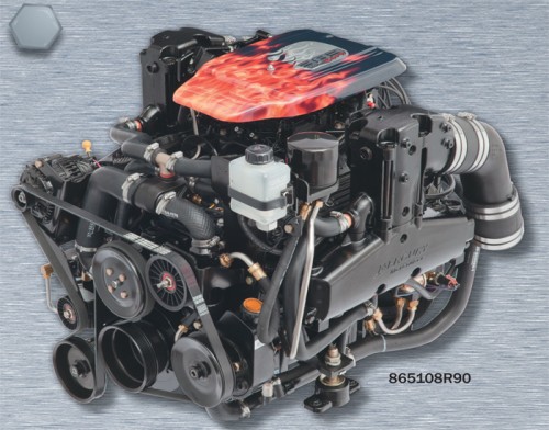

  1. bolsado
    bolsado Member
    Dec 19, 2008
    139
    Sacramento
    The new engine
    357 mag alpha 4v 275 HP

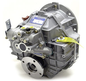

  2. bolsado
    bolsado Member
    Dec 19, 2008
    139
    Sacramento
    repower trans
    ZF Hurth 63A 8 deg down angle 2.5:1 ratio

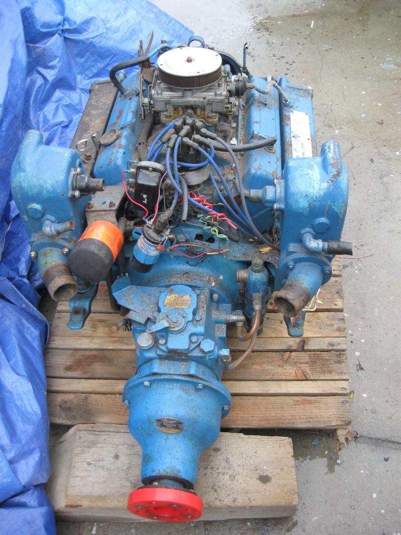

  3. bolsado
    bolsado Member
    Dec 19, 2008
    139
    Sacramento
    old motors trans out of boat
    pulled the old motors out with forklift at the yard

  5. bolsado
    bolsado Member
    Dec 19, 2008
    139
    Sacramento
    It was the flame job that sucked me in
    Actually found an alpha on cl for about 1/3 retail
    Really wanted 383 but it looked like shaft replacement too
    Turns out the alpha being a little detuned compared to the bravo matches the 427 hp as discussed in previous threads
    Higher rpm of course and less torque but opportunity knocked and had to open the door

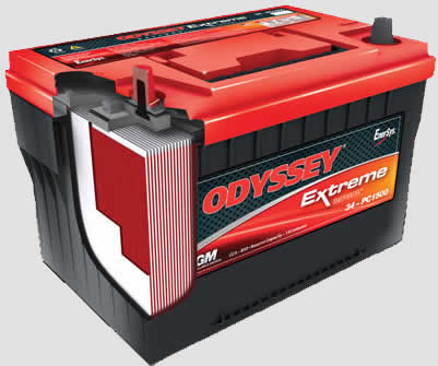

  9. alloyed2sea
    alloyed2sea Moderator
    Jan 28, 2004
    872
    Alex, VA
    Overkill or uber alles?
    Hmmm,..., Edison would be proud, only it kinda (from here) sounds like alot.
    My marine electrician (Clean Marine), and I use that term sparingly, recommended some Odessey high performance drycell AGM batteries.
    Odyssey Batteries
    "The Odyssey battery ingeniously uses absorbed glass mat (AGM battery) technology to offer, in one box, the characteristics of two separate batteries. It can deep cycle as well as provide enormous cranking power."
    These aint cheap, only he sayz we just need one for each motor (PC2150S) and a slightly bigger one for the house.
    Thatz a grand for three batteries, sheesh!
    He has them in his boat and claims miraculous performance, just like the sales brochure:
    "ODYSSEY batteries have an 8-12 year design life and a 3-10 year service life. Welded internal cells enable it to withstand extreme vibration, and AGM design holds acid in place to prevent spills, even when installed on its side. And unlike conventional batteries, ODYSSEY batteries can be stored for up to 2 years and still be returned to full power."​
    Am relly (relly) sick and tired of having the boat fail the "7/11 test" (park/walk-in/buy beer/leave/start motor(or not); and having to replace (read lift out of engine room) every 2-3 years.
    "No adding water, ever, no venting of acid gas, holds a charge longer, recharges much quicker, better warranty, no prorating with Odyssey, service life of 7-8 years......"​
