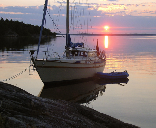

  18. AMG
    5,392
    These guys are trying, with the same designer as Fjord and Wally, first out is a 45´and a 62´in the pipeline. At least they are modern looking: http://www.moodyboats.com/index.php?id=874&no_cache=1&L=6
    My own motorsailer is from 1974 and still able to take me anywhere, not in a rush, but safe and dry...:)
