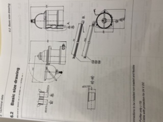

    I pulled the top part of the unit, everything appears in place. Manual isn’t very detailed it a kind of those ikea style illustrations with little explanation. Any idea welcome? Reluctant to try it again as it means 20 minutes of mopping up.

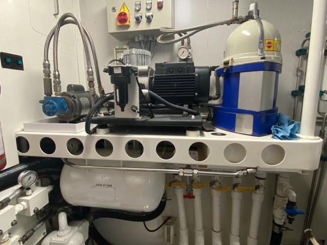

    The bottom of the unit is the tank of waste that it creates when spinning out the waste particles......did you empty that tank?

    On ours the tank is mounted under the shelf... I was wondering what it was! Didn’t see it mentioned in the manual!
  4. Pascal
    8,167
    Here is the setup. Indeed there is a tank built in under the shelf with a nice drain shared by the pump drain pan. Pretty well done actually so if the pump leaks it s all caught
    the Alfa Laval manual doesn’t show the tank that’s why I never looked for a tank. There is a switch on top of the tank which I guess is to turn off the unit if the tank is full... but didn’t turn it off in this case.
    I ll check the tank level later on
    can’t believe the tank was in my face :)
