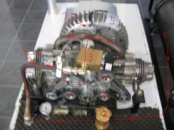

    Hi, everyone.
    Sorry, TRY, I had to use one of Your pictures ...
    So, let's think ...
    1. Compressed air is stored in vessel, marked as 1. As mentioned, 300 bars.
    2. Then it is led through air reducer (mark 2). I assume, that You reduce it till 30-35 bars...
    3. Then, through the solenoid (mark 3). It can be of a directional or propotional action. I think, propotional (to regulate air flow).
    Guys, this is "right pedal" (in cars).
    Or, another version, this is a powerful heater...
    4. Position 4. Probably there are two pistons on one connecting rod ?
    But for sure, double expansion is used (cylinders have different diameters).
    5. Pos. 5. Honestly, I am not sure. It can be a temperature sensor or a shaft's angle magnetic detector ?
    6. Positions 6. Wow. This motor has multiple PTO shafts. Or, or ..... may be even this is a motor without conrod (in this case all these wheels are used for kinematic schema).....? Or, (again) or, such kinematic is used to "delay"
    pistons at TDC... ?
    7. Very interesting "piece". Rotating damper ? Air vane motor ? Cooler / fan ?
    8. And whole unit is placed on a heater (that white box) ?
    Guys, sorry for too many ORs, MAY BEs, PROBABLYs.
    TRY, please confirm / decline my expectations...
    P.S. For those, who still did not get it...
    If You have ever seen diesel engine, starting on compressed air ?
    Imagine, that there is a lot of compressed air, what is efficiently used...
    But diesel engine will not have fuel system at all. It will turn only on air...
    But some problems to solve:
    1. Compressing the air. Solved. (Use ENVIROMENTALY clean electricity to drive compressors).
    2. Storage of big amounts of compressed air with such pressure (300 bars).
    (That is why TRY reports us "usage in not big applications). Partially solved.
    3. Effective usage of compressed air. TRY already mentioned some ways to do so. Well, ideas are still welcome !
    TRY, please reply...

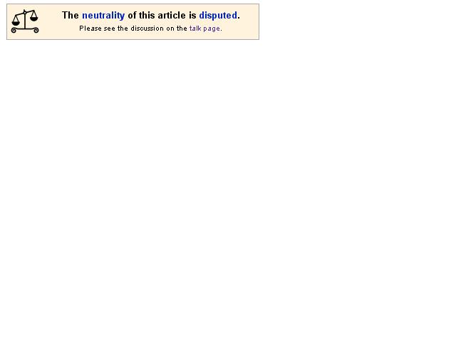

    Check out the disclaimer
    I love the banner atop your Wiki link. Can't quote it exactly, (that was yesterday,) but something to the effect that this technology remains debatably to be proven. I think we all just love fancy pictures, James Bond cars and sleek trophy 'models' to go with them. :)
    Try,we're just having fun at your expense. I am proud to see anyone eager to push the envelope.

    Do you mean this disclaimer?

    First, I would like to remind you that this thread started off as an informative action, just to let all of you know that alternative solutions were being worked on, and we do not at all suggest or think that we're the only ones!
    Therefore I will reply to questions which go this way of thinking, not to provocative and questioning or dubitative remarks (I still don't understand what American football had to do with this topic).
    Andrei - (TSI-AV) - summed up a number of fair questions in his reply #83:
    1 =correct
    2 = correct
    3 = correct
    4: no, in the photograph it's a two cylinder engine of 600cc, with normal same-size piston cylinders, and the compressed air delivers its power in a single expansion step.
    5 = negative
    6= negative
    7: this part of the unit is the electric generator (220VAC) pack. It serves as an alternator (in a car), as a starter motor, or as the compressor drive when feeded with 220VAC.
    8: no, this is just the support plate of the sound damping case. We don't need a cooling system since no heat is developed.
    Andrei is correct in saying that this engine is only as clean as the electric power it uses to replenish its tanks.
    A major advantage is that the engine is ZERO pollution where and when in use to drive.... whatever (car - genset - forklift - industrial tow tractor - boat).
    This, plus its modest volume and weight, opens a lot of new applications.
