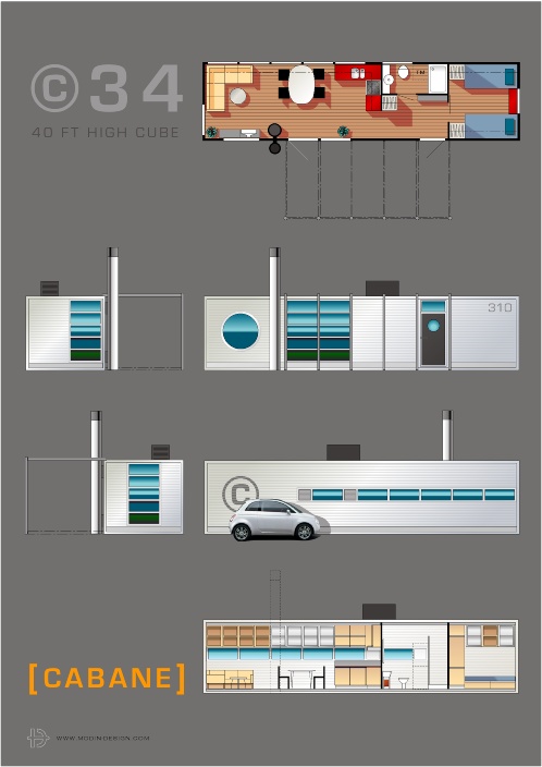

    As several million people in Asia suffers from the effects of the Tsunami and are now without a home, my first thoughts was about how to be able to create a house that can be built and transported there as swift as possible.
    The total reconstruction of the area will take at least five years it is said, and therefore something much better than tents has to be built until the final structures are in place.
    I have earlier made a proposal for a container house, initially thought for use by students or as a first residence before you could afford a proper house. Also for events like the Olympic Games or other non-permanent needs of housing.
    This is based on the high 40-foot container in its widest form suited for land transport. It was intended to be built with an aluminium frame and composite walls. The interior and windows should be flexible within the system and heating and sanitary systems depending on the local environment.
    I know there are many obstacles in transferring these ideas into the best solution for the homeless in Asia, but I think it would be a good idea to start thinking about how and if it can be done and this is what I will do now.
    This thread is not about yachts, but I think there are many similarities in the construction and that there might be useful knowledge and contacts among the many members and visitors on the YachtForums.
    Anyone who wants to contribute to make this idea into a real project or discuss the feasibility of containers for housing in the tropic environment are more than welcome.
    Lars
    Note: The illustration is from my files and not adapted for the purpose I suggest above.

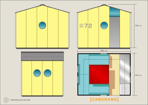

    The Container house is a little on the expensive side and above all, will take a long time to get produced in large quantities.
    Living in the land of IKEA, I have made this low cost, fast built version today ;)
    With a structure combining particle board and aluminium in sections, the basic version is 8 x 10 feet. This would be enough as a shelter for a small family. The production cost can probably be less than USD 2.000 in mass production.
    As a kit, it would be easy to transport and to set up. At least it is much more of a house than a tent or a tarpaulin shed...
    What do you guys think?

  7. AMG
    5,380
    As I understand the situation, most needed is water, food, clothes and homes for people who has survived in all of the devastated areas around the Indian Ocean.
    I don´t expect any poor Indian to come and buy a house, but with the massive worldwide contributions isn´t it possible that he can get it?
    The actress Sandra Bullock alone gave USD 1.000.000, which would provide up to 2.000 people with a house (500 houses) as the one I suggest!
    I rather think that now is the time to do things, than wait until it is too late. But naturally there are many things to consider, not least what the local people have to say about what is needed. But I have already heard that tents are washed away by heavy rain in some areas...:(

    I think your idea of self construction is good enough for some parts of the world, but as you have seen after the US hurricanes and several earthquakes that has hit remote places, there are different climates and different people who will need housing pretty soon after a disaster, why I think a stored supply of "clic-clac"-houses like the Cabanana would still be a good idea.
    Maybe they could be sponsored by big companies like Coca-Cola, with logos if they so like, and be swiftly distributed more or less the day after the next disaster to minimize suffering...?
