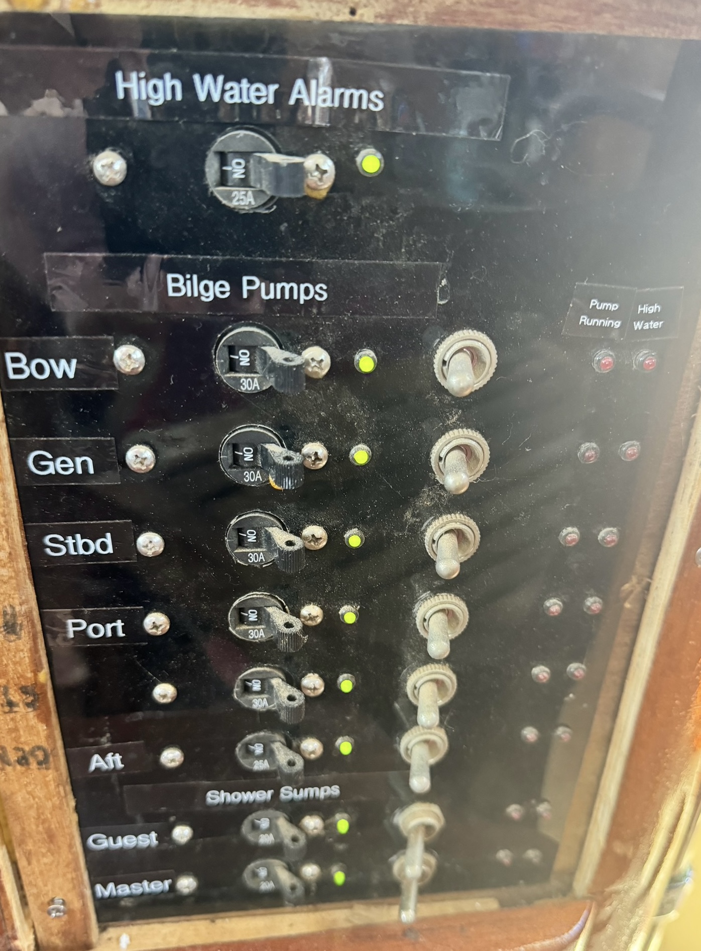

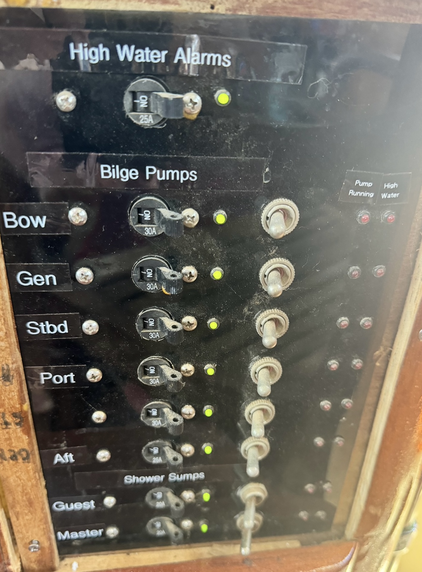

    here is what I did on my 53 seven or eight years ago, it was the first I did before installing the chillers and repowering .
    I ripped all the old pumps and wiring and ran new harnesses to each location.
    Each compartment has a rule 3700, float switch, high water float switch. The panel has a breaker for each pump, an over ride manual switch, a red high water and pump running LEDs. Plus a green showing each pump breaker is on and a breaker for the high water alarms. I left a spare in case I want to add an extra pump aft and included controls and LEDs for the shower sumps. Haven’t gotten around to adding a buzzer… one day
    I sleep better at night :)
