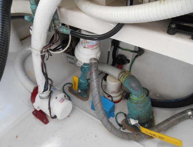

    Admin Edit: This image has been reduced to meet our guidelines.

    Behold the above shot of a 31 CABO X aft bildge! Got the photo to upload. The most forward pump is the fish box macerater. Large through hull is for a bait bag set up no longer used. Smaller through hull/pump is for the molded into the stern bait system. Affending bilge pump is far aft just below high water alarm lights.
    Bamboo, I don't think I want try to limit how I operate the boat because of this problem. It needs some mechanical fix. The best answer seems to be a "loop" and or a check valve.
    Based on the limited view of the photo (can not really see where the hose exits), the solution looks like an extended/new hose leading up to the underside of the sole with the proper hangers, then a check valve in an accessible location (maybe just off the pump?) Configuration and sophistication is up to you. What's the rating on that pump? Looks a bit small.

    This topic made me think quite a bit, even though it started out as a pretty small localized issue. Would like to complete the picture with a shot of the discharge thru-hull above the rudder shelf inside the transom.
    Taking time to summarize options:
    • A vented loop is always the preferred option, but needs to be above the waterline and the vent needs to be serviceable as it will clog over time.
    • A check valve - depends on a lot of things but MUST be installed above the waterline, so precludes it from being near the pump, then should be horizontal after the thru-hull but before some "loop" or up-hill hose run before the drop-off to the discharge side of the bilge pump. But needs to be serviceable, as even non-corroding types can foul due to sea crud. Another issue will be if the Rule pump can push hard enough to "swing" the check-valve open, a Rule 500 or 1000 maybe not, but a Rule 1500 or 2000 maybe so, you would have to test it to be sure.
    • A manual ball valve like the OP originally suggested, would just entail switching the thru-hull to include a ball valve. But this is totally manual and up to the OP to keep track of. Am a little surprised at the corrosion levels of the thru-hull fittings, so hard to say how detail orientated the OP is, there appears to be some checking/cleaning of bronze fittings/hose clamps/steering line fittings needed. Back-up systems lend some security, but the potential for burning out the bilge pump with a closed discharge thru-hull exists.
    • Another simple option - a non-corrosive (rubber/plastic) flap over the discharge opening on the outside of the transom?
    But like all things that fail mechanically, you need to treat more than the symptoms and get down to what is the root cause?
    • Negative transom pressure at pre-planning speeds causing the wake to "roil" (is that the right word?) attach itself to the transom and force its way back?
    • As Bamboo suggested, chopping the throttles or de-accelerating hard when coming off of plane?
    • Since the thru hull may be only 4" above the waterline, just basic wave pumping action from vertical hull movements while fishing or on anchor, enough to force seawater back in?
    Having the underside of the cockpit deck so low to the waterline (maybe the OP can measure and give that dimension?) may limit the effectiveness of a vented loop, leaving the inline check valve as the viable solution, but one that needs to be monitored to ensure the flap does not stick closed. This makes it almost as equal to the manual ball valve. To get a better and more effective vented loop would require cutting the cockpit deck and mounting it well above the waterline, something you see on commercial vessels but not practical for a 31' Cabo? UNLESS, of course, you have room up into the transom coaming and can go higher than deck level, may require some re-routing away from the centerline transom bait tank/fish hold, going to one or the other side of it?
    I might be inclined to get a flap on the outside of the discharge as a first step and see if it does the trick. This would be a simple and relatively maintenance free first try. But I would certainly call Stan Miller Yacht Sales in Long Beach, who have sold a ton of Cabo's or Basin Marine in Newport Beach, who have commissioned plenty of them and get their opinion as well.

    I'm away from the boat right now that's the only picture I have on the iPad. When I get to look at it I'll see what it is I can do. You all have been a great help for me getting to the best possible fix. Thanks to you all for your suggestions! I'll update once it's done. I'm really not a hack...my PVC valve idea aside!
    Seeking to learn. Why above the water line, considering, it seems, he can't even get a loop above that level? Query: Why the heck is seawater even coming into that individual system in the first place? IMO, the thru hull is in the wrong spot.
    The flap will not stop water intrusion at the dock, but, agree, it is a solution for stopping some back wash. When I'm backing down out East, I wish my scupper flaps were that efficient, 'cause if I ain't wearing boots I'm on my butt wrestling that 4 lb. founder that took my 5 lb. bait.
    Joe, we all are just exploring the bad, the good and the best solutions. You are kind to put up with us

    By keeping it above the waterline you get technical alignment with ABYC and also with Rule centrifugal pump requirements. It does get somewhat complicated depending on discharge hose routing and how much gets completely evacuated - if there is too much static head for the Rule pump it can become a "cycling" issue with the discharge water being pushed back and forth.
    It is an interesting dilemma for such a basic issue but one that many SF have to deal with since there cockpits are so near the waterline (some lower than others).

    Why not just spend a few bucks to install a diaphragm pump and be done with it?

    I agree, after reviewing the many possibilities, seems like the easiest solution, something like a self-priming Jabsco diaphragm bilge pump (with a built-in check valve) and a strainer for the pick-up.
  20. Capt J
    14,896
    Diaprahm pumps don't have nearly the volume of a Rule 2000, plus the ends usually break off after a year or two. A checkvalve at the thru hull or just before it is above the water line with the boat at rest so it would meet ABYC standards and that is what I would do.
