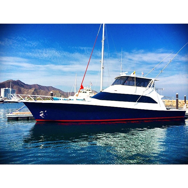

    yeah, that sounds better than paying almost 3k just to have all 24 injectors checked out which is what they wanted to charge me. I'll run it for a while after they finish the paint job and I'll see what happens. This boat wasn't run very much so it could also be that. Thanks for the advice.

    Turns out the injectors were OK. just needed clean fuel and the engines to be run for a while. she now cruises at 22 knots and the engines sound nice. blue color does not look so bad. Only issue is fuel leaks on one of the stbd tanks...

    794
    isleton, ca
    That looks great! Did you paint house and decks also? Awlgrip?

    Looks nice.
  5. Capt J
    14,898
    The boat looks great.
    I would get on that fuel leak very quick, because if it's the tank, you may end up with 400 gallons in the bilge overnight one day.

    that´s exactly what happened. We lost over 400 gallons of fuel to the bilge. Obviously could not pump it out to sea. made a huge mess. pumped it out to a truck.
    for the moment I´m using the port side tanks until I figure out what to do about the leak (which I haven´t completely identified). taking out the tank is a huge job. Any suggestions?

    Thank you. And yes, awlgrip, and I did have the decks and lower section of the house painted, had to, it was all stained.
