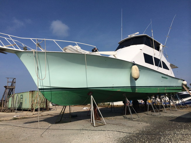

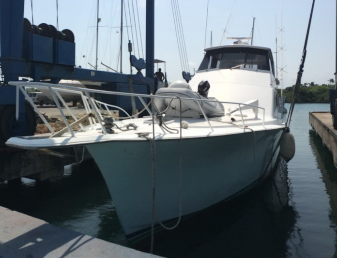

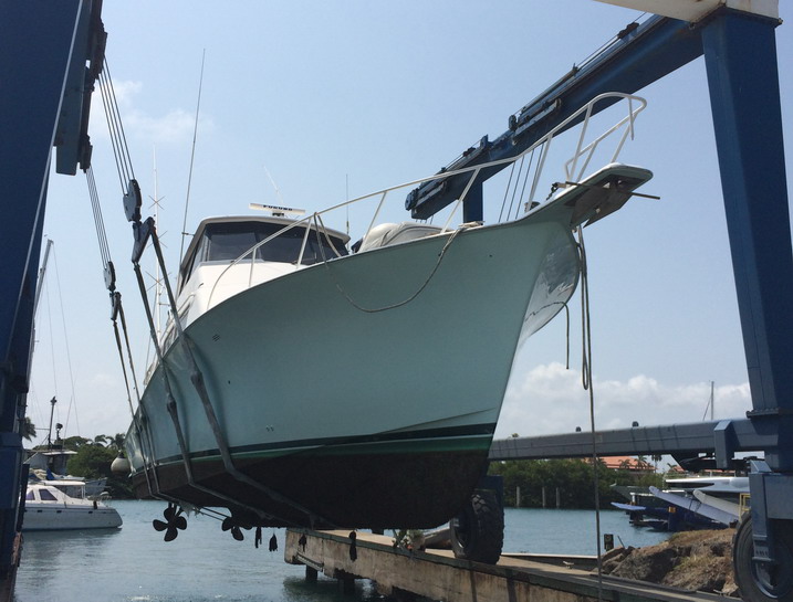

    So I trialed the boat a couple of times before buying it. The first time it was only making about 16 knots and putting out a lot of black smoke. Obviously some turbo issue. Told the owner I could consider the boat if he fixed the turbos, so he did. Then I tested the boat again and this time it was making 21 knots at 1900 rpm, which was not bad. But I noticed the temperatures were running a bit high (180 on port and 195 stbd). Now, normal temperatures should be between 170 and 180 right? also had some vibration on the port side, and it would smoke a bit at idle. I finally decided to make a very low offer considering the money I know I need to put into the boat, and the owner accepted it. I know the engines need some work, but in my opinion, 3412s are good engines that wont take much to bring up to shape. I hauled the boat out to install a new westerbeke generator. I bought a 15 Kw Gen, which i think should be enough. the old one was a 25 kw but in terrible condition. I´m also painting the hull with a dark blue. Would aprpreciate any advice on the engines.

    Guages or gun? Cats run hotter than Detroits. It might be time to service the heat exchangers and it looks like you accounted for that in the price - it's good to know what you're buying.
    You might want to think twice about painting the hull dark blue. I don't think the Ocean 66 molds have the quality for it. The ones I've seen have a lot of wavy-ness and woven roving imprint that doesn't show in light colors - and that's before we get into maintaining it.

    Also, I've heard that down south the dark blue exterior can really change the heat index for the areas below decks? dunno. Nice boat , good luck with her.

    Thanks for the advice. Unfortunately I´ve already bought the paint and they´ve started working on it, so I guess I´ll just have to see how it turns out. Did service the whole cooling system, and found the heat exchangers to be very clogged. I´m worried about the slight smoking at idle, plus an oil sheen in the water coming from the exhausts. I´m guessing the injectors need servicing (it´s light colored smoke, white/blueish). The engines only have 2000 hours on them so I don´t think they need an overhaul yet.
