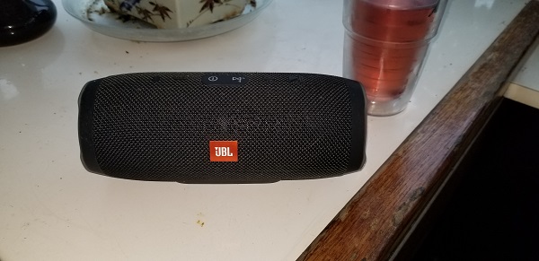

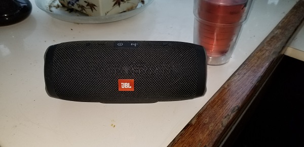

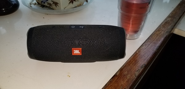

    Josie and her son put a few of these JBL Blue-tooth gizmos onboard last year.
    WOW, loud and clear. Local volume or master from your phone or main stereo.
    So far, sitting in the open helm area, they get morning damp but never sprayed on directly.
    My fancy built in speakers went to poo in a year and grills started rusting out in 6 months.
    Looking forward to get more this fall.

    I hope that's a rum a coke next to the speaker!
  6. Capt Ralph
    12,742
    Light Zinfandel. Been easy on the rum these days.
    Cheap wine and/or cheap bourbon latley.
